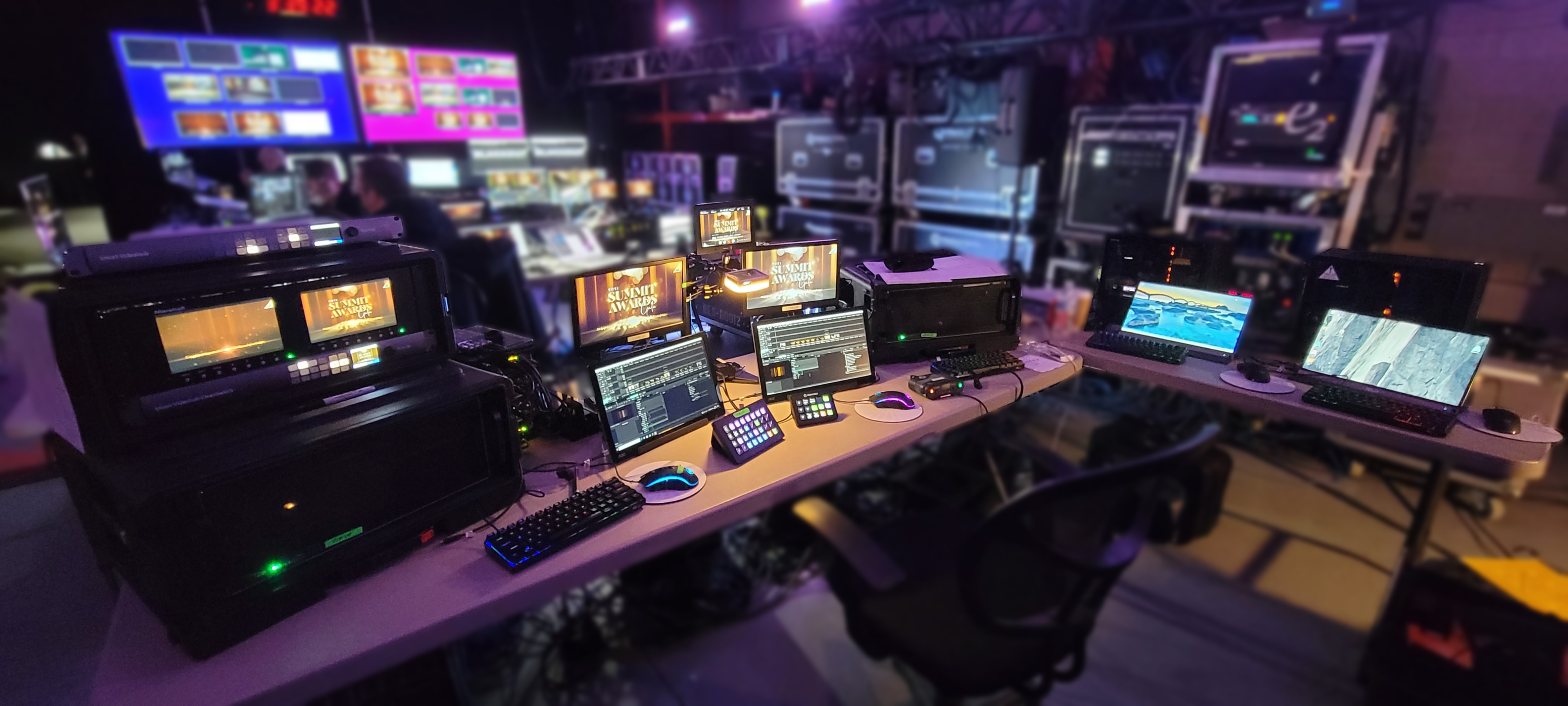

This is exactly what I use Resolume for Corporate/Ballroom stuff. I can do 12 2K outputs. The transition element you are talking about is totally doable. I use them all the time. I call them Alpha bumpers. They have to be on top of everything and exist everywhere on that layer, that way you can switch columns and everything below switches but the alpha bumper has its in and out. On the out it reveals whats switched underneath. Looks killer. Watchout sucks dude. I had to reprogram a whole show in Resolume because Watchout just couldnt handle it
. 27000X1080 LED wall. The best thing about Resolume is that it is non linear. I seen too many server guys struggle when a change in order happens live, if you are linear u gotta scramble.
