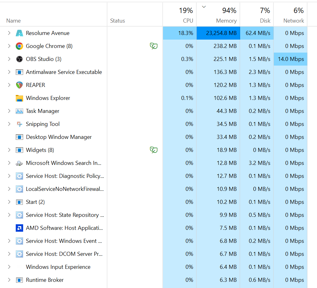

It's back at 95%:

Weird that the system would say 95% memory usage, of the 64 GB I see about 30-31GB listed in the task manager.
If you open up Resolume and just play a particular clip or source, do you see the memory usage climb consistently?
If you don't change clips or decks, the usage should stay about the same.

Looked at it about an hour ago, had gone down to about 45%, from 70% when it started. Looked at it just now, still about 45%.

Alright, try triggering some columns then. You should see a a bit of an increase in the usage right on trigger, but then the RAM and VRAM usage should stay steady.
Do you see the same hiccup on transition when Resolume is started fresh, and not using lots of RAM?

It always goes back to 90-95%, freezes/hangs/hiccups at transitions. So if I had, say, 384gb of RAM, would it still go to 90-95% and freeze?
And no, it seems pretty much fine (maybe a freeze on occasion) until the RAM goes up to 90-95%.
