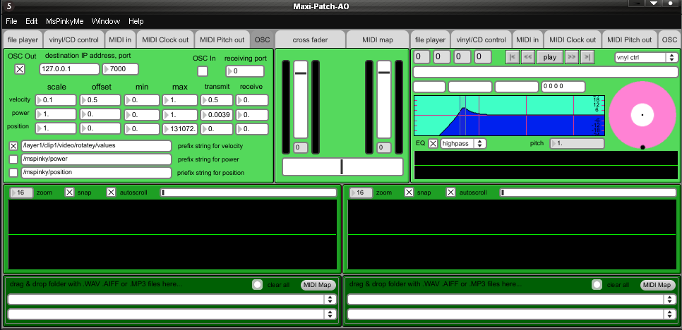

They've just released the new version with the added scaling feature, they basically put this feature in for us Resolume users
isn't that nice of em, I think it's really cool!!
So, I'm still a little unfamilar with osc in Resolume, can anyone tell me if the way I have this set up is right?
It looks right to me, clip is on layer 1, clip 1, I think the port and address is right, but. . . . maybe there's just something I'm not getting? I'm trying to link the y-rotation at the moment.
