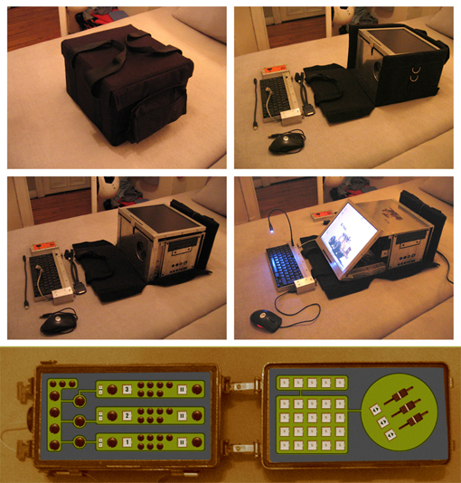

since a few weeks we are talking about a midi board on http://www.vjforum.de but it is german language. i recognized that every vj has its own way of working, so there is no right way of the keyboard layout. i build my board in photoshop, push the layers and buttons around until it was right. then i printed it. and checked the distance between the knobs and sliders. my last one looks like this:
i used the CTM64 and the Pocket Elecctronics from http://www.doepfer.de
the jogdail is waiting for a connection in res....

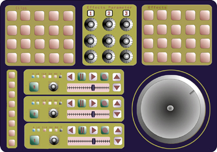

at the moment i'm thinking of this layout... (going to use midibox pcb's).
or maby this... not sure about the 3x grid thing :)
a touchpad (i think) can be very handy... and maby a preview tft. i'm planning to use al square keys (with a cap you can take of to put in an other lable or something)

much fun to build my own laptop. its an Shuttle Barebone sb65g2
i will put the midi interface in an old army radio-box
tim :)
