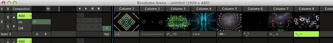

As a workaround, I have once abused the clip names to identify clips.
Screen Shot 2012-06-07 at 3.53.20 PM.png (101.28 KiB) Viewed 5853 times
We'll have another look at clip colours when we dive into version 5.
