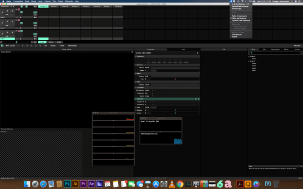

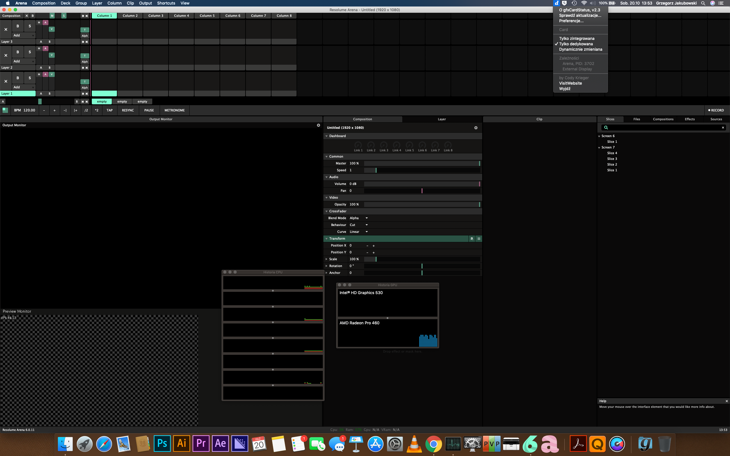

So, i disable all apps running, istats etc.
there is still the same problem,
as you can see on the screen with new comp it is still droping fps 35-60
on the GFX graphs 60 is the high value, and droping is going down on GPU.
What is interesting i used just NDI yesterday with comp size 3800x1080 px with 4/5 layers dxv 3.0 and sending 2 ndi outputs with 6 slices without any problems with fps, it was still around 60.....
so problem cause only when external display is connected by hdmi....
what now ? :D

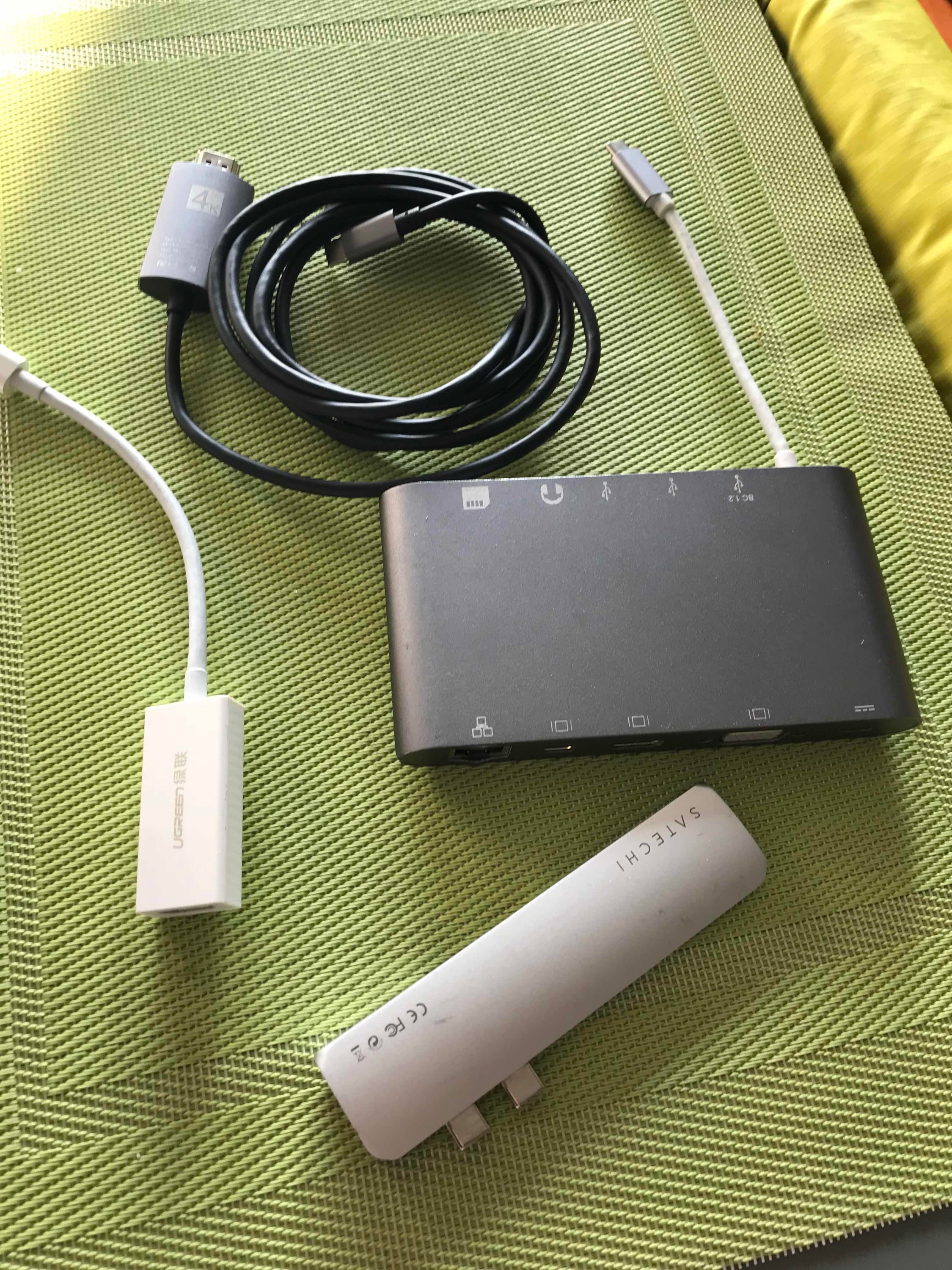

What kind of cable/adapter are you using to connect to your external display/projector?
2Vision
Posts: 18
Joined: Mon Oct 15, 2018 11:25
Re: Resolume 6.1 on Mojave .. Problem!
Post by 2Vision »
All of these, and with all its the same problem. So i think its not adapter but res with macbook problem...
