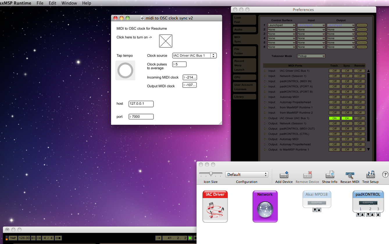

there is an 'address' in audio midi setup in network and an IP in system prefs > network so which one do i use?
ive tried both and had no luck.
i have sync and track output to the IAC bus in ableton
i have the midi input on the max patch to IAC bus
i set the host IP to the resolume laptop
in resolume ive set the input to network and to iac and both had no results
the network has been connected in audio midi setup > network and the computers are connected ok.
im getting some weird message pop up on the patch. have a look at the attachment and compare it to the tempo you see in live... weird!
Screen shot 2010-12-23 at 17.54.57.png (772.2 KiB) Viewed 9781 times

I see that in Ableton you show an Output To Max/MSP Runtime, you should use that.
In the Max patch, you should be able to select Ableton as the clock source.
127.0.0.1 is the localhost, it is the IP address that refers to the same computer. If Resolume is running on another computer, then do this to find the IP address:
1) On a Mac, go to "About this Mac", press "More Info" button, find the Network category, you are looking for the IPV4 address.
2) On a PC, open a command prompt (Start -> Run -> "cmd"), type ipconfig. Look for the local IP address.
The IP address will probably be in the format 192.168.0.100. It will change on every network you connect to, don't assume it will always be the same.
Enter the IP address of the Resolume computer in the Max patch (that is running on the same computer as Ableton).
