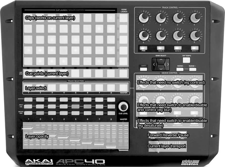

olivepixel
Posts: 57
Joined: Wed Jun 23, 2010 11:31
Re: AKAI APC 40 and Resolume Avenue
Post by olivepixel »
Very interested to see how other people are using all this control, I think sharing mappings here will help everyone get the most out of the APC.
I've had mine for a couple of weeks now, so still tweaking but this is the set up so far:
By using the 'device control' for effects, I'm able to have 12 effects on each year (4 modify only, 4 modify and on/off and 4 on/off only). At the moment I'm using the same selection of effects on each layer to make it easier to remember where I am.
I have a lot of the controller unmapped at the moment leaving room for future expansion. Not tried the midi feedback bodge yet.

Cheers and thanks for the mapping template too. good to see how people use there :)
