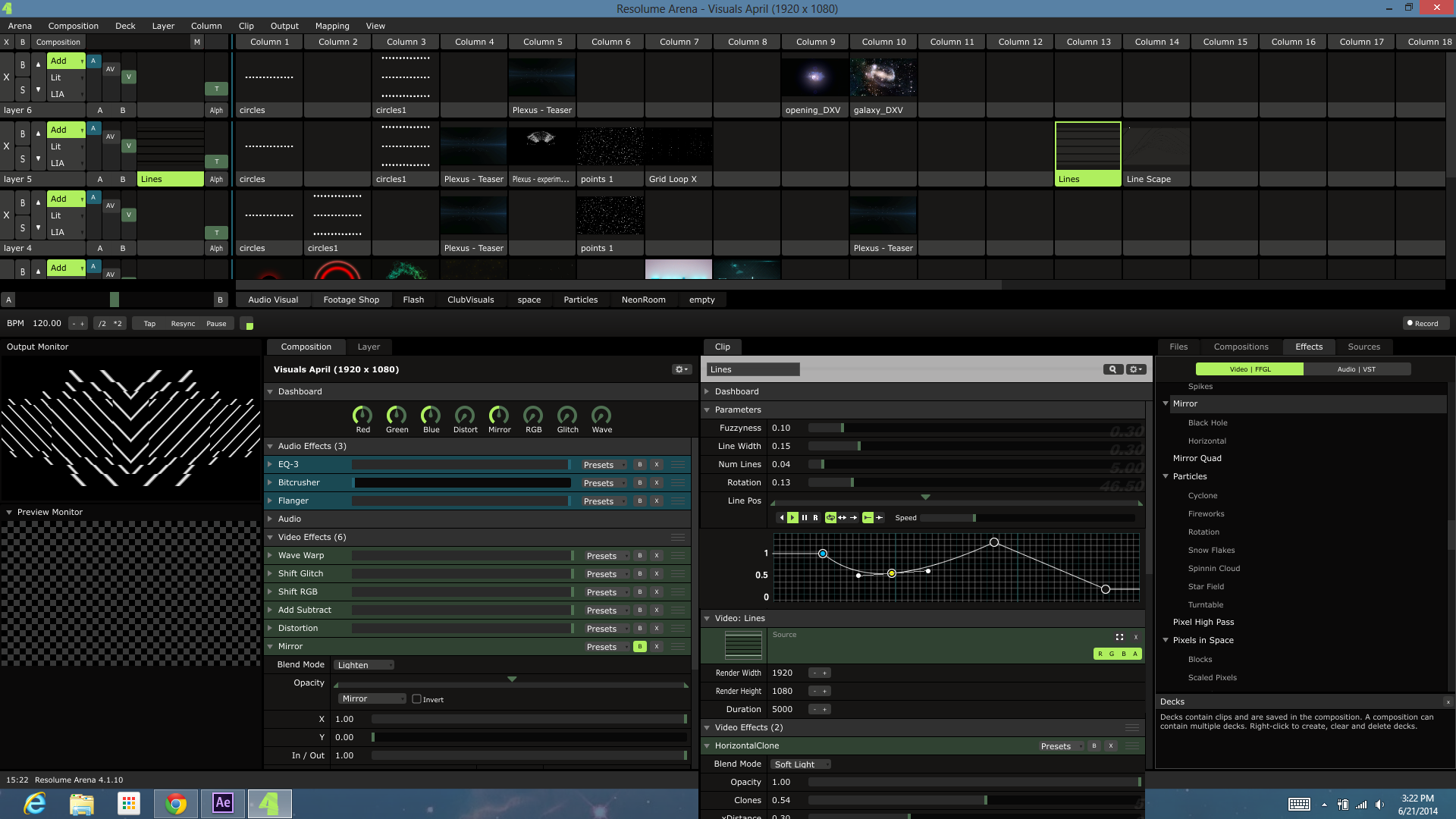

I hope resolume 5 will introduce a timeline something along the lines like this (see attachment), or what we have in aftereffects to draw the curve blocks seen in particular and others.
Example has blue for straight lines, yellow for bezier curves.

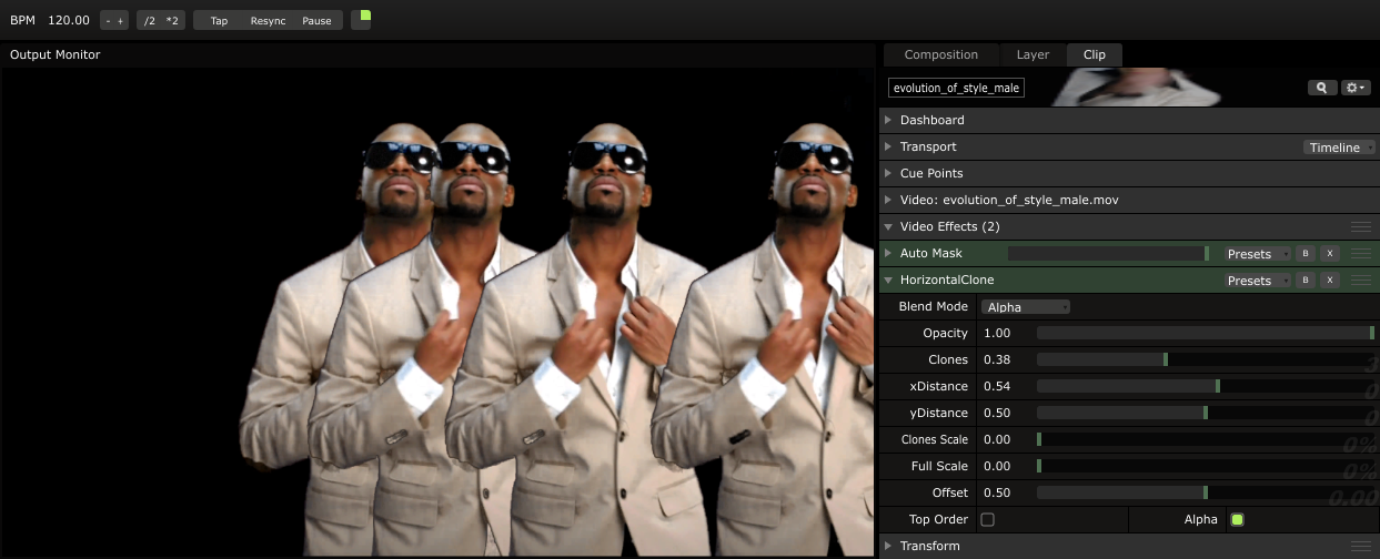

For your testing please check "HorizonalClone" in effects
Now with alpha toggle, y distance, orginal scale, offset left and right.
Please report back if problems. OSX version coming as soon i have a Apple computer :).

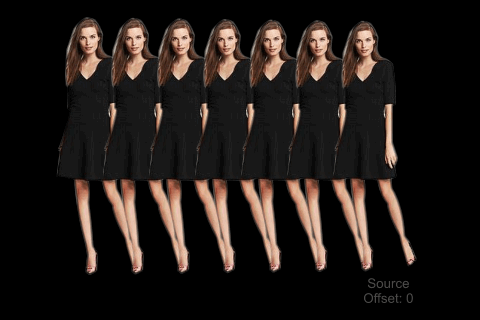

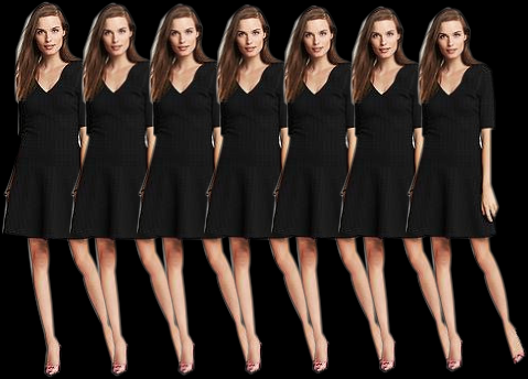

The distribution of clones is non-linear even when unscaled.
Here is a mock-up of a linear distribution:
Currently the offset moves the original image and its clones horizontally. My vision for the offset would not change the location of the source or its clones but would affect the scaling, y-position and any other clone effectors. So, with 5 clones, an offset of 3 and a scaling of ~20% would give this sort of effect.

Perhaps in order to cater for a wider range of situations or preferences you could implement a slider for adjusting the profile of the distribution...
And just to add some detail on the offset feature, even when the clones are unscaled, the offset will determine which clone is on top (or bottom depending on the "on top" option) and the clones on either side of the offset source would recede or proceed accordingly.
Demonstrating a changing offset on unscaled clones.
