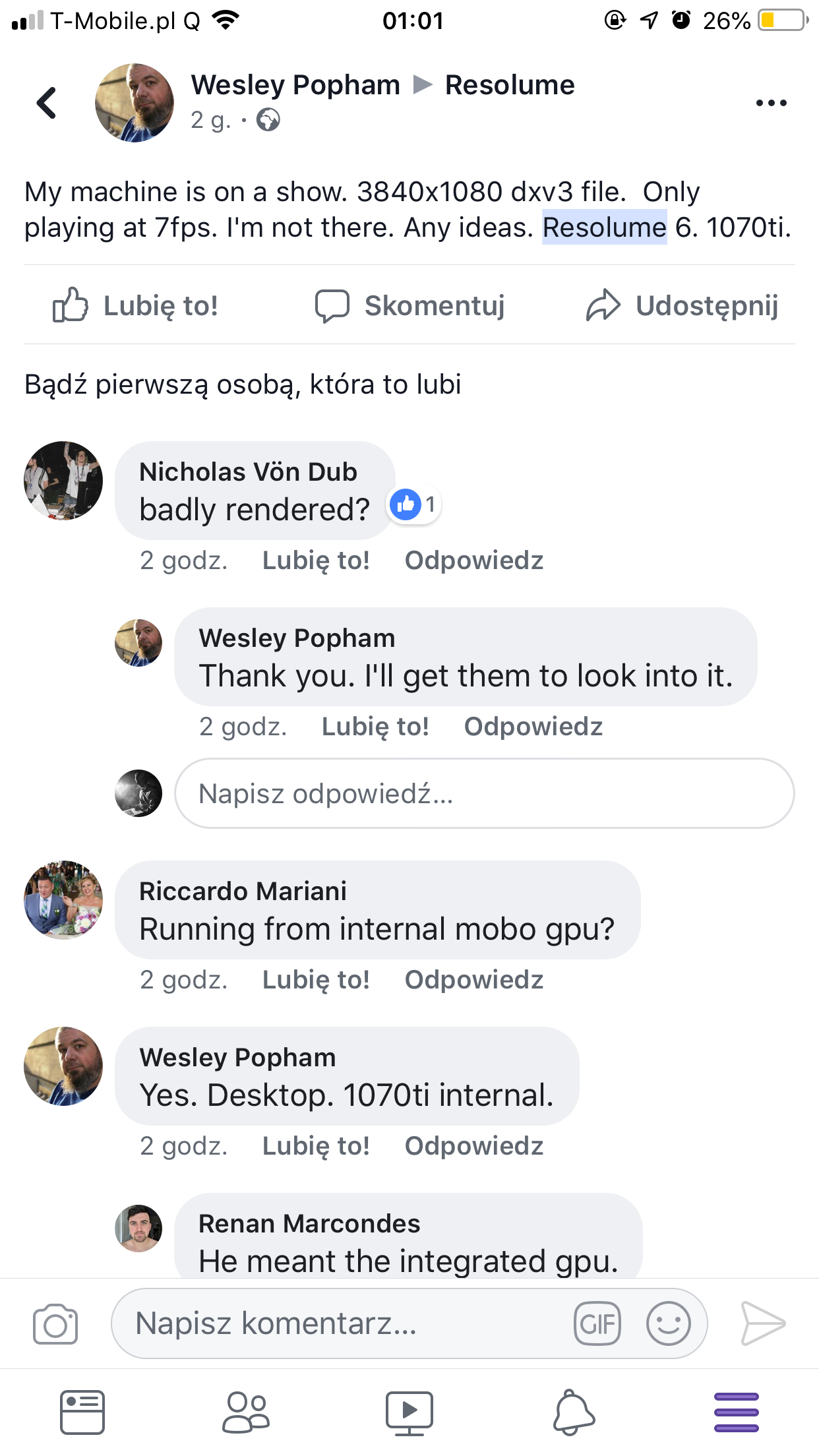

Did you read resolume group on fb? Many people report fps droping using 1080ti and other good specs. So i see its common problem with new resolume.
Re: Resolume 6.1 on Mojave .. Problem!
I sort of follow the FB page and see a couple of isolated cases but not that many people especially when you think about how many people use Resolume in the world! And then once again, the MBP you have is a different beast than a PC using a 1080ti so highly irrelevant.

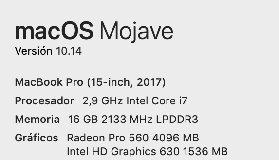

Not sure. Can you describe your whole setup?
Resolume Arena 6.1.1
Captura de pantalla 2018-11-05 a la(s) 10.28.18.png (57.76 KiB) Viewed 8734 times
