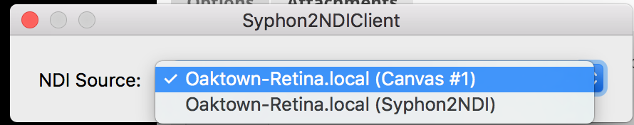

There are a few download links scattered about, so the latest copy of "Syphon2NDI" by Techlife is available here. The latest Spout version will always be available from the download page.
I don't use OSX so I might be missing something, but the conversion from NDI back to Syphon should be done by "Syphon2NDIClient". Then Resolume should then list it as a Syphon source.

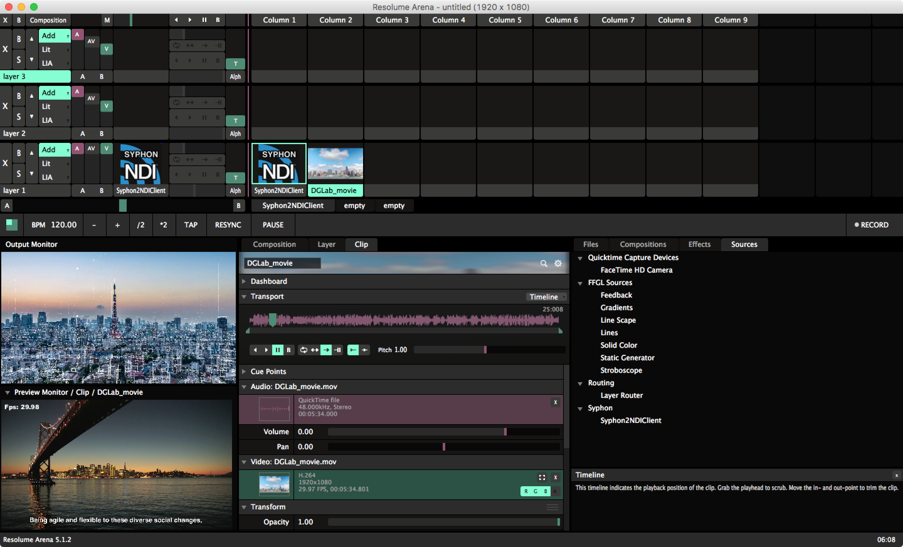

Correct, you pick the NDI stream in the NDItoSyphonClient Then you use it in Resolume as you would a normal clip As a note, because it's using Syphon technology, there is no audio stream.I don't use OSX so I might be missing something, but the conversion from NDI back to Syphon should be done by "Syphon2NDIClient". Then Resolume should then list it as a Syphon source.
Re: NDI support
Thanks Oaktown! That was it! Didn't know the NDI client was also available for an input source. Very cool.
Thanks for all the help. This is going to be a game changer for me (Broadcast and live festival use)
