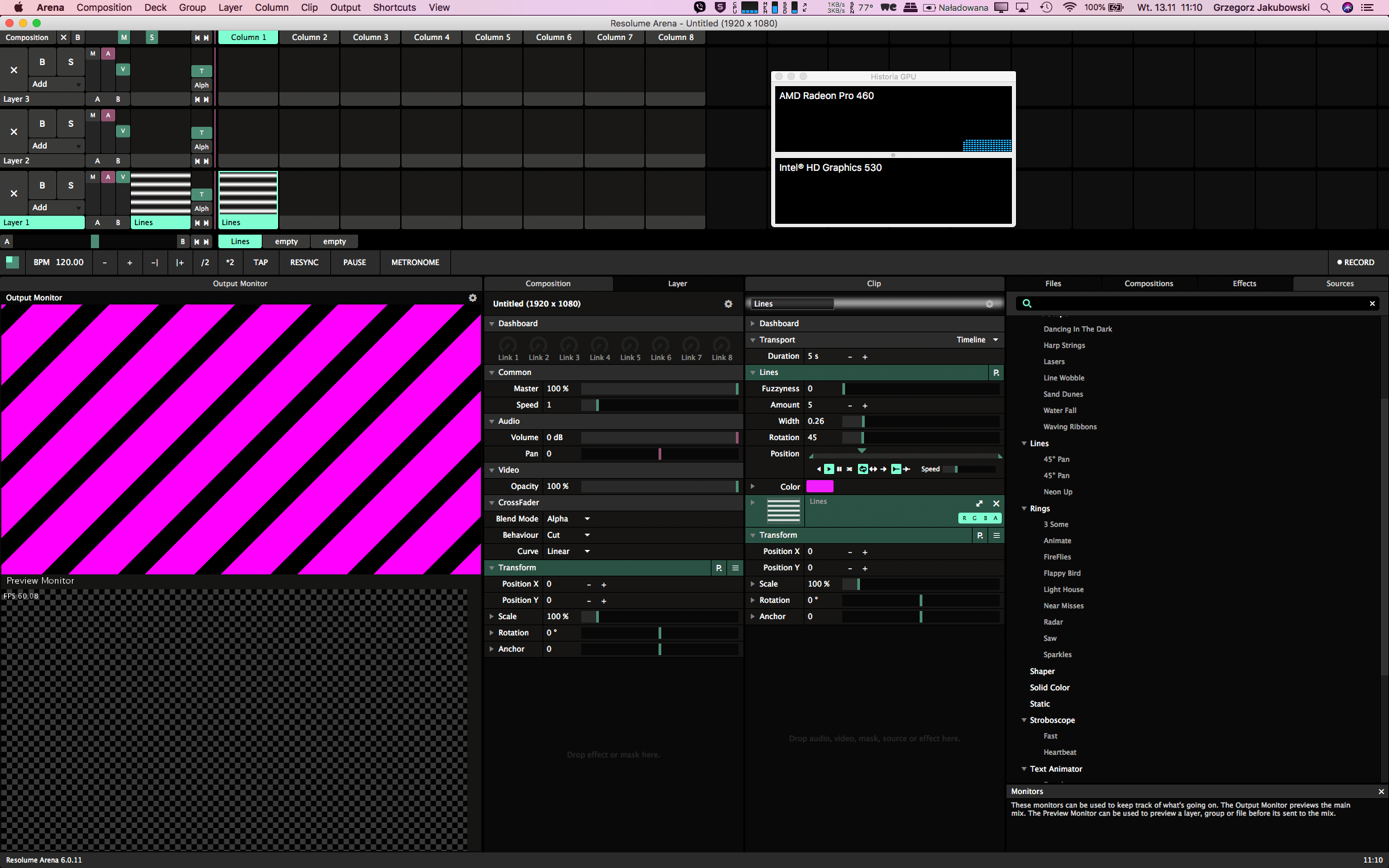

Ok so, i just back to High Sierra and Older resolume and there is no such a problem like on mojave, so maybe it will be easy to find solution. And as i can see the GPU is working lower and its on same percent without jumps.
Zrzut ekranu 2018-11-13 o 11.15.33.png (7.04 KiB) Viewed 5987 times
Zrzut ekranu 2018-11-13 o 11.11.25.png (84.25 KiB) Viewed 5987 times
how abot now ? :)
