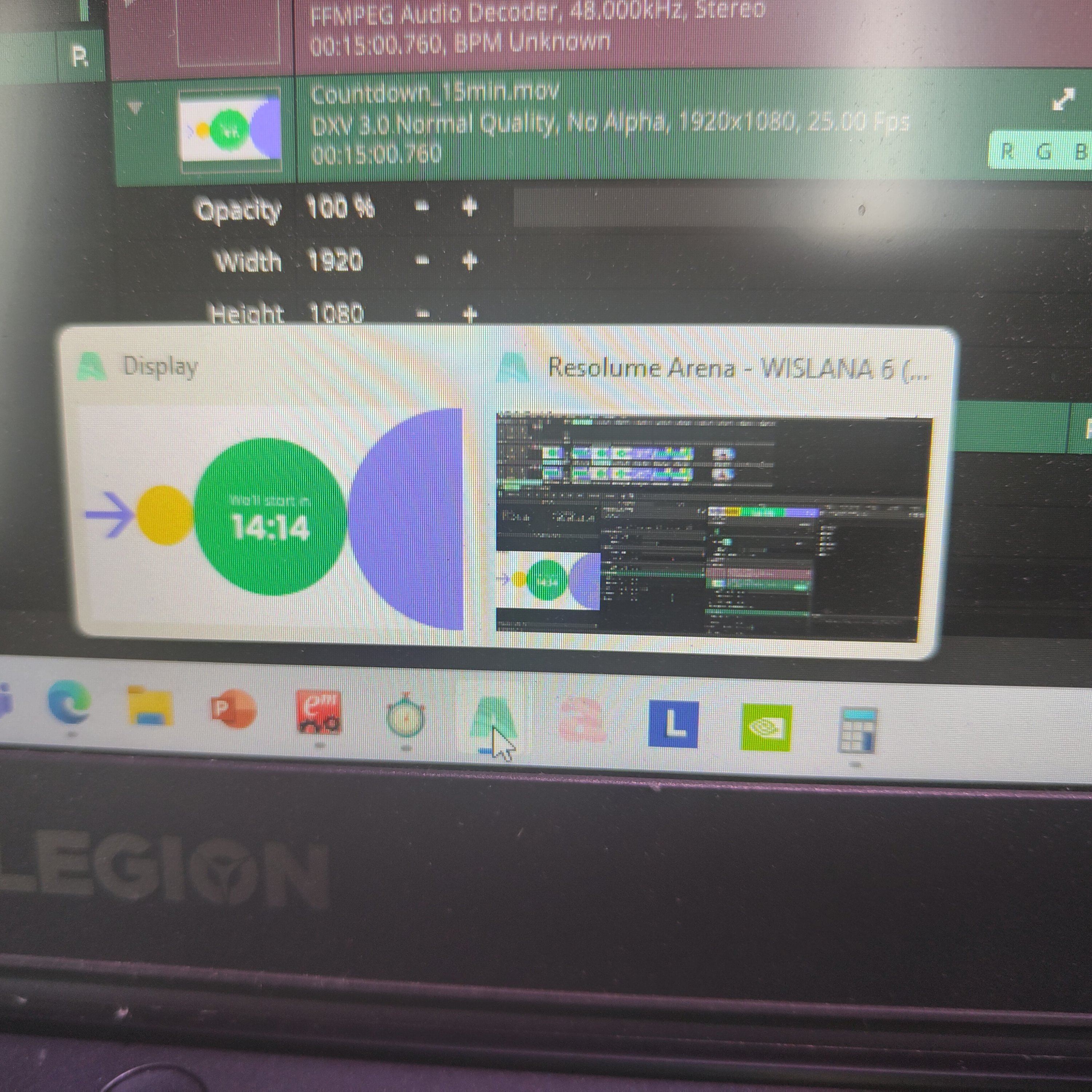

Re: Output flickering
I have the same problem. I just noticed that the image jumping is visible in the preview in the start bar.
I conclude that this jumping creates the resolume itself.
