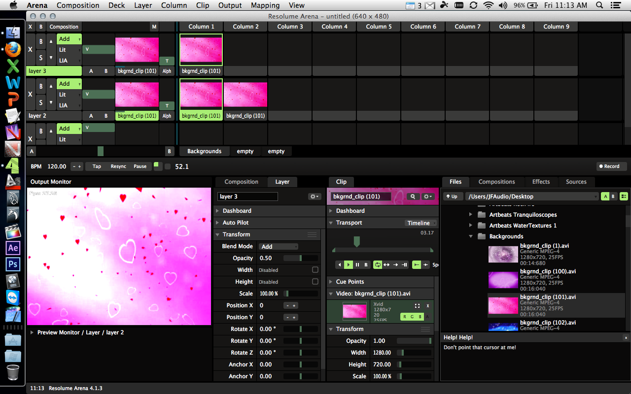

you can put the same clip in every column and layer if you want to, just drag and drop it from the filing section to wherever you want it
here you can see the same clip in two different layers (layers 2+3) and two different columns (column 1+2)
If I want to play both layer 2+3s clips together, all I need to do is trigger column 1. Playing around with the transfer mode on layer 2 lets you manipulate the way they blend together, and you can get some interesting effects out of it

Thanks LXConcepts! That's exactly what I was looking for
