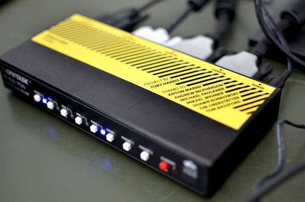

The Spark D-Fuser is basically a remote control for the TV-One 1T-C2-750 Scaler. That sounds a bit 'un-glorifying', but if you ever had the displeasure of working with the TV-One bare bones, you know that it is in dire need of a better user experience. This is what Toby Spark thought as well, and it became his ten year odyssey to create exactly this. Braving sirens, cyclopses and sleepy toms, this finally resulted in the Spark D-Fuser.
Put simply, it allows you to connect two DVI sources, fade between them with a crossfader, and send the resulting mix as one fresh, crispy DVI signal. In the words of Toby himself: "Boom…"

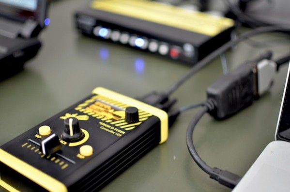

The overall look of the D-Fuser is very smooth. It's black and yellow color scheme is pleasing to the eye. We know it doesn't count for anything when it comes to how well it works, but hey, who doesn't like to look good in pictures?

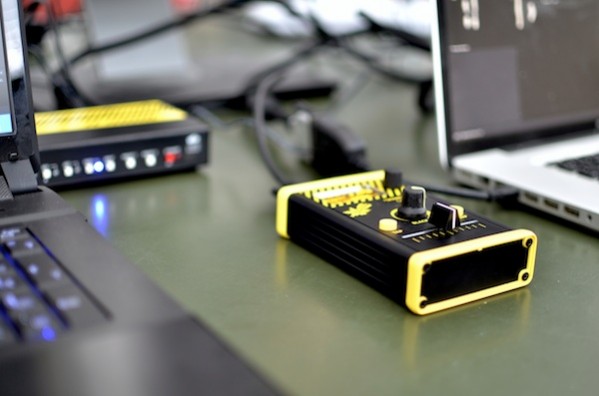

Toby kept the actual product to a minimum. The D-Fuser itself is a small separate box which connects to the TV-One scaler via an included RS-232 cable. This means that the total weight of the D-Fuser is less than a kilo, and fits snugly in your backpack. Anyone who has ever played the game of "how-much-extra-weight-can-I-fit-in-my-hand-luggage-before-they-kick-me-off-the-plane" can appreciate this. So can everybody that ever rode their bike to a gig with two laptops and a projector balanced on their baggage rack.
The choice to have the TV-One box separate however, results in 2 extra cables on the table, and on an already crowded space, this can get messy real quick. Also the control panel is still exposed, which can result in accidentally activating something on the processor during a changeover. Trust me that that results in hilarious panic all around.
On the up side, the separation does mean that if you do need to dive into the TV-One menu itself, it's easily accessible. Also it keeps the clutter of connection cables out of sight behind the laptops, where they belong. The controller is what matters, and this can fit easily on any table.
The controller itself feels a bit plastic, and does not really feel meant for quick mixing. For VJ use, on an already messy table, it can be hard to quickly find the right knob to fade out when you missed a musical cue. Any attempt to get some rhythm going with the crossfader results in the device making laps around the table.

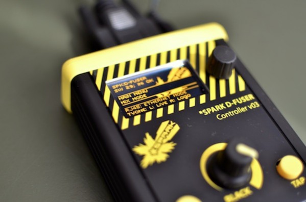

This is where the D-Fuser really shines. It's very clear that Toby spent quite a few nights with his baby, coming across every problem and thinking of a good way to fix it. Setup is very intuitive, and once you get the hang of the onboard menu screen, you can setup everything you want without reading the manual. Which is good, because none is included. Extra info can be found online however.
The onboard menu itself is very well designed. It gives direct feedback on the important bits, and has an easy to navigate menu structure for the harder bits.
The TV-One does not have a preview output, which can result in it being a bit of a black box. The D-Fuser solves this issue by sending a Spark logo as long as no inputs are found. This is also reflected in the onboard menu, where the word Logo is displayed. This is actually very useful, because you can be sure that at first start up, a logo is always shown on the output. If this is not the case, you know the problem lies somewhere in the signal flow behind the D-Fuser.
The moment an input is detected, it changes it's status to Live. When said input is lost, the output is frozen. This makes it a very useful piece of kit for setting up before showtime. Once the signal is correctly detected and set up, you can take your laptop back to the hotel while leaving the D-Fuser running as an active input. When the time comes to plug back in, everything is handled smoothly without loss of signal.
The D-Fuser, or rather the TV-One, has one big drawback when it comes to connections: when for some reason the input is not recognized correctly, you're out of luck and have to figure it out by trial and error. No additional info as to why you're not getting a signal is to be had, which can be extremely frustrating when setting up in a stressful environment. This is purely a limitation of the TV-One, and if you really can't live with this, you're going to have to spring for a V800.
Choosing the correct output resolution is quick and painless, and has support for the most common digital resolutions, as well as dual head and triple head resolutions. Once the output resolution is changed, the inputs are scaled automatically to this new resolution, which results in quiet sighs of relief when struggling to get things set up correctly with the promoter breathing down your neck. For fine tuning, there are additional options for fit, fill and 1:1.
In case you're completely lost, there's also a hard reset option, that walks you through the key presses needed to reset the TV-One itself. It's little things like this that make the D-Fuser feel very user friendly and thought out.
