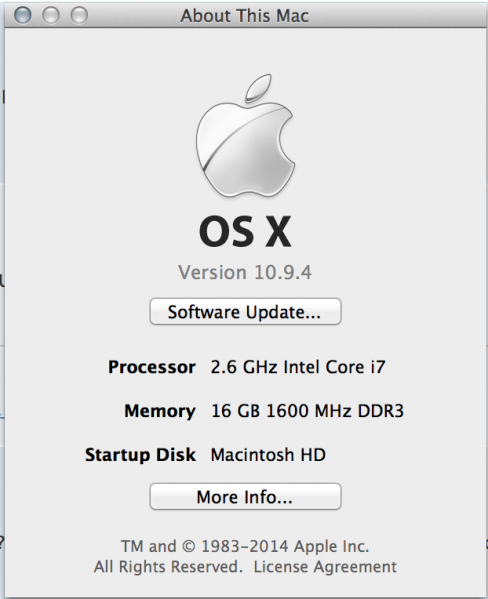

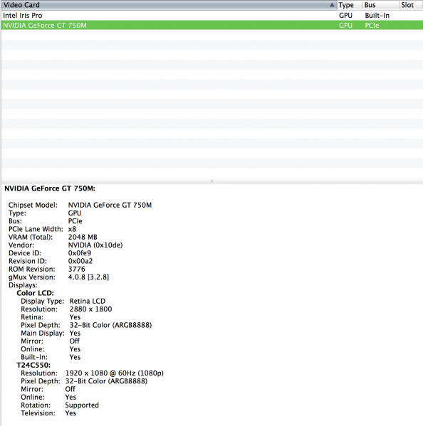

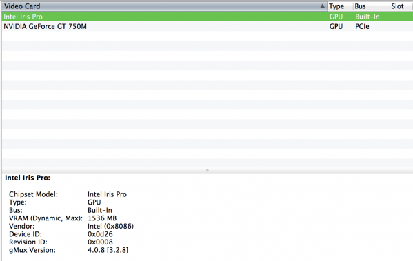

I've got the newest version of the 15.4" MBP with the Intel Iris Pro and the NVIDIA GE Force GT 750M (see specs below)
The following youtube video will show you the chroma key effect on my MBP: https://www.youtube.com/watch?v=T_tgKwr ... e=youtu.be
