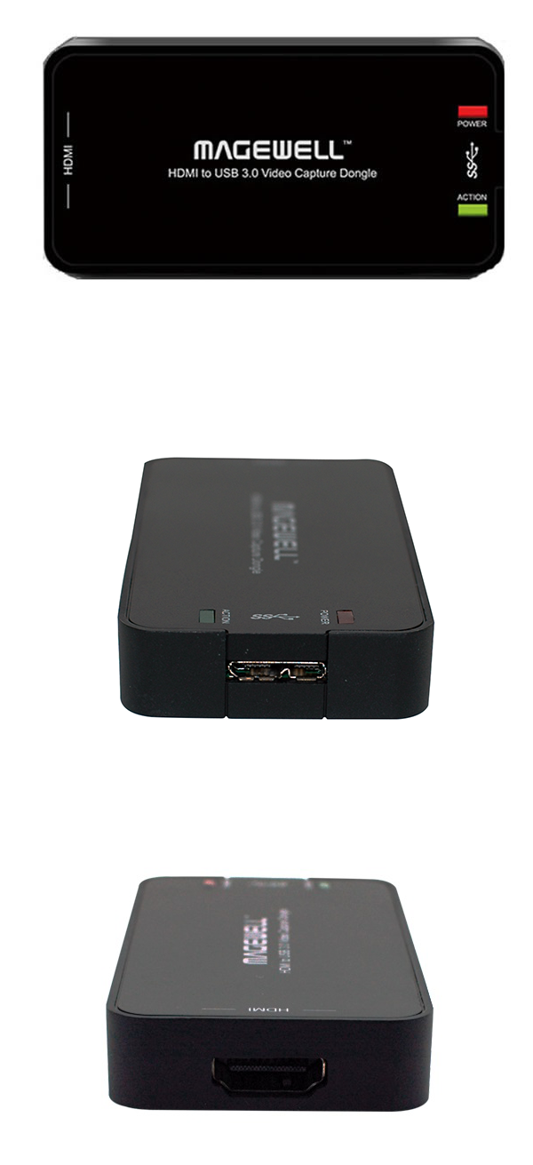

Hey guys,
after a long period with a lot of hassle based on incompatible USB chipsets with Black Magic capture devices I found, or better, Joris helped me to find my new personal Holy Grail of capture hardware. Here I want to share my experiences with this really cool piece of hardware with you.
Magewell XI100DUSB-HDMI
The manufacture Magewell promises a truly plug and play device. They don't lie! Just connect it via USB to your computer and you are ready to capture. This device don't need any drivers because it works with DirectShow like any webcam does.
This capture dongle automatically detects the resolution and framerate of the incoming HDMI Signal and scales it internally to the resolution and framerate you need. And this is the only "minus" when you are going to use it with Resolume.
Any common video capture software like Twitch, VidBlaster..ect. can access the dongle to configure its output resolution. Resolume can not do this because it not natively supports this capture device.
What does that mean?:
If you are using this dongle with Resolume via usb3 it gives you 1080p and via usb2 480p which is all-right for me.
I've made tests with an Alienware m18x R2 via usb3 and with a Lenovo T410 office computer via usb2.
The performance on each of the systems was really impressive. I would guess a delay of 2-3 fps with any tested input resolution.
In my test I captured another notebook which was playing a speech of a politician >> Watching the captured stream with Resolume and listened to the audio directly out of the captured notebook. Lip-synchronisation was okay.

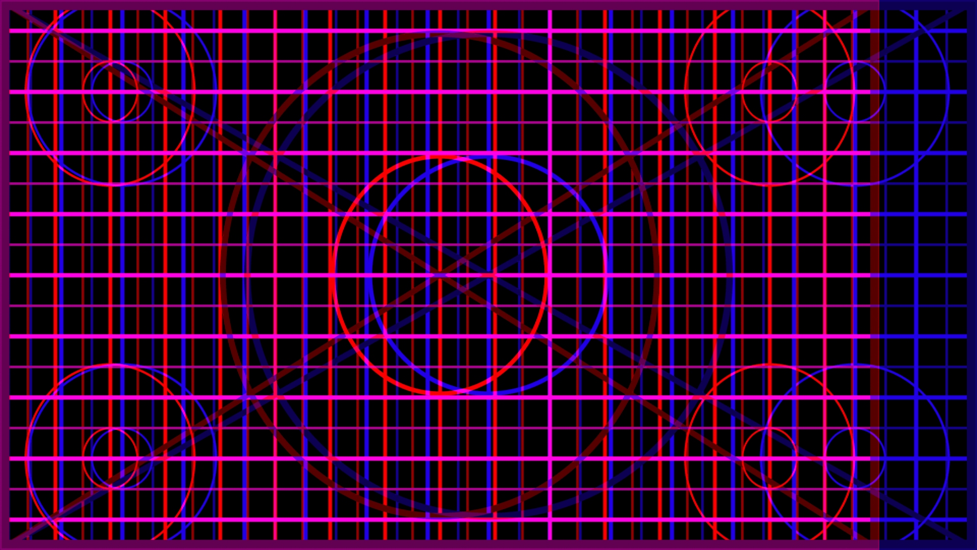

We recently also ordered the Magewell after reading your review, but in this case the SDI version
I am also very impressed with the results although we are experiencing one problem: the image get squeezed to the left as you can see in the attachment. Still trying to figure out why..

hmm...the pink/red grid is the squeezed input...and the blue background grid is just to show us how it should look like?..or is this the captured input in Resolume?
- What kind of signal does the dongle gets? Res/Hz/Colorspace
- What resolution Resolume shows you if you click on the input container?
- Make shure all possible transform/vfx configurations are reseted to default (I'm sure you checked this already)
- Preview your SDI signal with an SDI monitor
- Test your Magewell dongle with another software and check if the squeeze issue still exists. (VLC, Skype, xSplit...)
- Try another SDI source
That would be my suggestion hitlist to find the bug ;)
Greetings
P.S.:
I found the following in the manual!
Recommendation: In actual use, first plug SDI cable, then plug the USB3.0 interface.
Because an SDI signal sources are often not reliable grounding, Ground and the
computer will be relatively large voltage difference, it may cause the signal source or
capture not working properly.
Frame Rate: Set the output frame rate, currently supports
25/29.97/30/50/59.94/60 fps
Color Space / Compression: currently offers two kinds of color spaces, YUY2
and RGB 24
Output: Set the screen output size, resolution is currently supported
640x480/720x480/720x576/768x576 /
800x600/1024x768/1280x720/1280x800/1280x960/1280x1024/1368x768 /
1440x900/1600x1200/1680x1050/1920x1080/1920x1200, the default output is
1920 * 1080.

Thanks for the input cosmowe, I will run some tests tomorrow too to try that out
Blue was the original source outputted to a v800, Red was the SDI coming out of it back into the laptop.
The odd part was the container sticked to 1920x1080 during my tests even when I was changing resolutions and unplugging and replugging. Need to run some more tests tomorrow trying to completely remove the source or restarting Arena.
