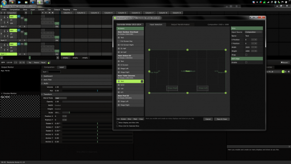

I'd like to see the layer router embedded in each layer control, with ability to turn it on/off.
When it is turned on you would be able to control the incoming video input as well any slices it is connected to in advanced output.
If Layer 6 has text and is routed to a single slice on 4 different screens, I would like to be able to turn the slice off on the layer side, instead of opening advanced output to turn it off.
Advanced layer routing

Re: Advanced layer routing
Yes, this would be a very good feature to have.
We'd like to discourage people as much as possible from using the Advanced Output window in a live situation. It should be used to set up before show, or to touch up minor mistakes during performance. It should not be used as a performance tool.
So adding some way to control the opacity of slices ( or groups of slices ) at the composition level is a very good approach.
To be completely clear on this particular use case, why would simply fading out Layer 6 not work in this case?
Having to put text on 1 screen, not all screen at once.
I have several LED that I send content to.
LED1. 1408x540 "dj"
LED2. 1728x480 "outdoor"
LED3. 384x288 (3 "columns" of 128x288)
LED4. 128x576 "pool dj"
Layer 1-5 : Main composition mixing
Layer 6 : Dedicated text layer for main composition
Layer 7-9 : LED3 "Column" routing
Layer 10 : Text layer for columns
Layer 11-13 : Different routing options for LED2
layer 14 : Text layer for "outdoor"
Because the LEDs are all different sizes/ratios I have different flash text clips for different formatting.
It would be much easier to route this from 1 layer and turn off the screen I don't want the text on. Instead I have to scroll up and down to get to the correct layer (not a huge deal).
This behavior, would break the functionality of being able to transition between layer router and another clip (like a camera).
I will try and make a tutorial or something about my setup (with lots of pictures and arrows). I know it's difficult to follow, I have a hard time trying to train someone on how to properly run everything.
Which is all the more reason we need to work more on making it more accessible and intuitiveit's difficult to follow, I have a hard time trying to train someone on how to properly run everything.
Yes i like this, instead of calling it route to layer, call it rout to slice. So you be able to select your slices as output (same as you would select your input layer routing). Then you be able to stack them as well in the effects cue. Plus have all the normal parameters on the effect like, Transform, Rotate, Scale X Y, Anchor Point X Y, cropping would already happen since the slice has its size in the advanced output. Just my 2 cents.
We won't be adding features to layer to slice routing anytime soon.
If you have a use case not covered by the Slice Transform introduced in Res 6, we'd love to hear about them in a new thread.
