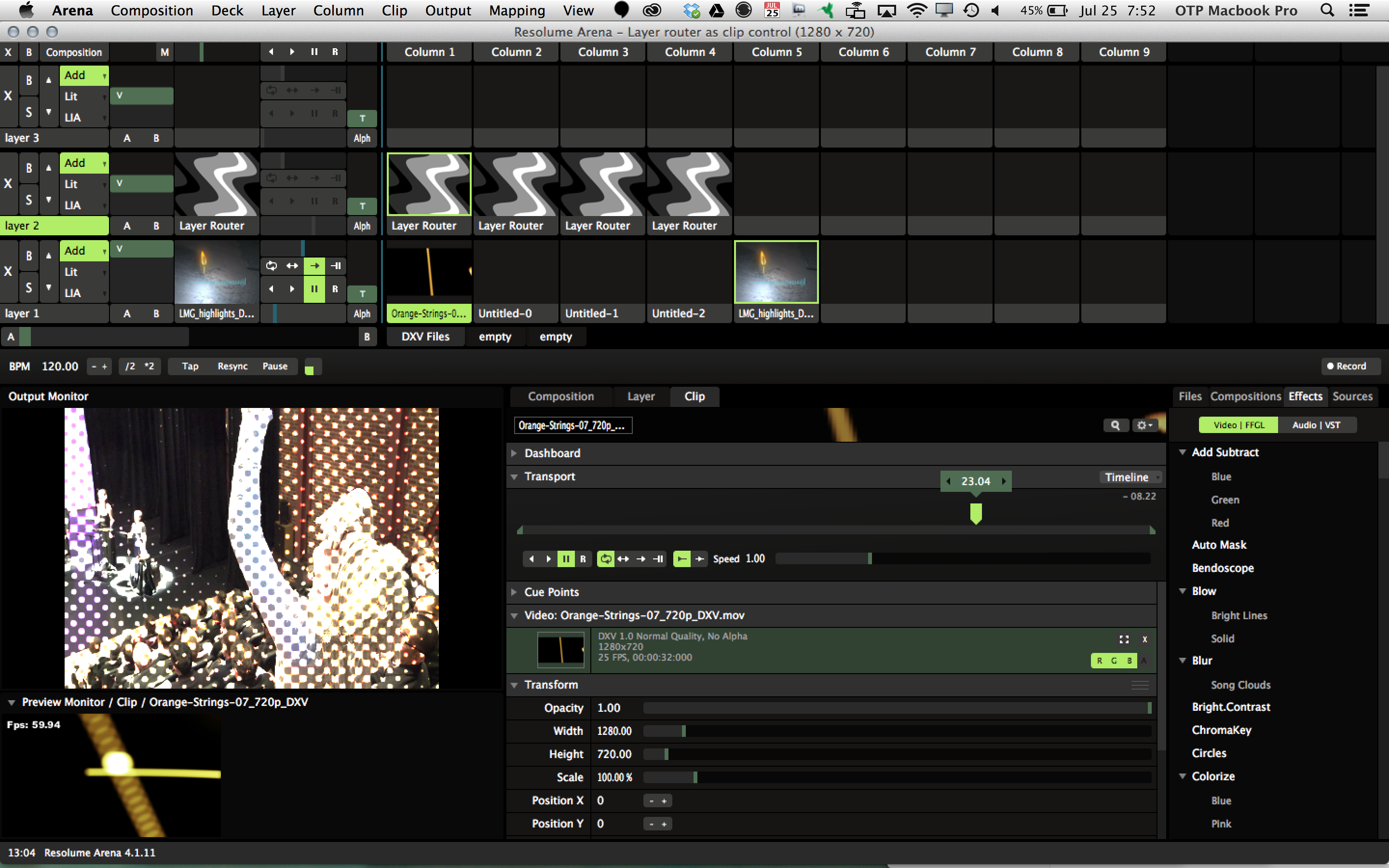

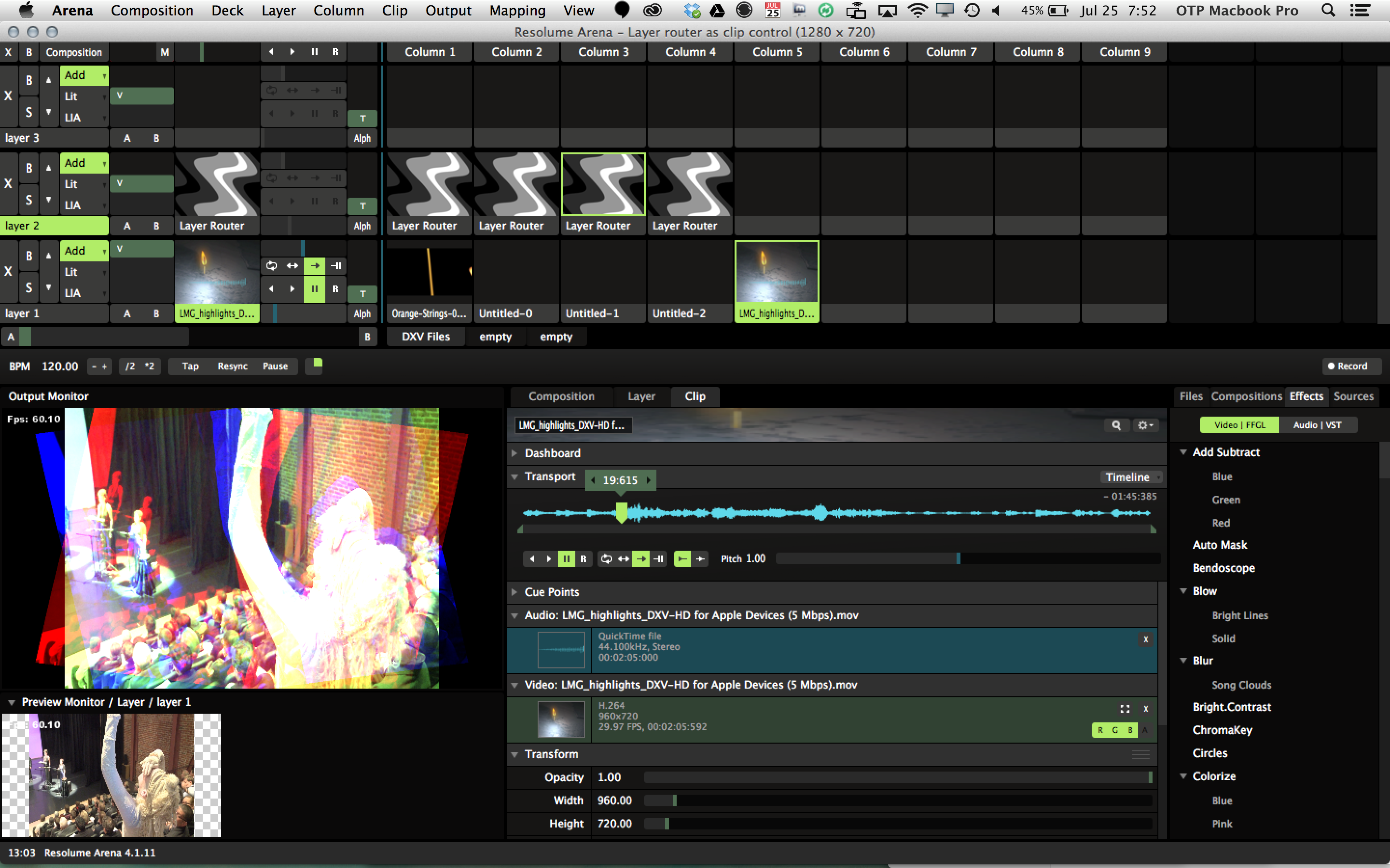

It seems that I'm getting both formats on different clips (both DXV)
HH:MM:SS:MS where MS is MS, and HH:MM:SS.FF where FF is the frame by using '.' instead of ':'
For instance the Orange String file is SS.FF where as another clip I'm using is SS:MM.
Any thoughts?

Ah yes, when the clip has audio, the number is in millis.
Re: Clip "load" question
Thanks Joris, this is good to know.
Also if I remove the audio track from the clip, it switches to MM:FF automatically
