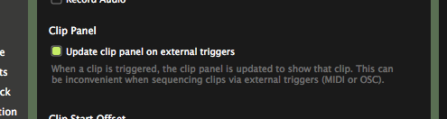

Re: OSC to do a Clip->Cut ?
Could it be you have Update Clip Panel turned off?
nosuchtim
Posts: 11
Joined: Thu Jan 05, 2012 22:57
Post by nosuchtim »
The "Update clip panel" switch is turned on (I've never turned it off, so I assume that's the default). On further investigation, It looks like that feature doesn't work in release 4.1.7 (at least, for the ctrl-x issue I've described). Happily, it appears that somewhere between 4.1.7 and 4.1.11, this bug was fixed. When using 4.1.11, ctrl-x will work properly, at least when manually typed after using OSC to preview a clip, where it didn't work in 4.1.7. I'm still not yet seeing the ctrl-x work programmatically, but since it now works in 4.1.11 when manually typing ctrl-x, I assume I'll be able to get it working programmatically as well, soon. Thanks for the help!
