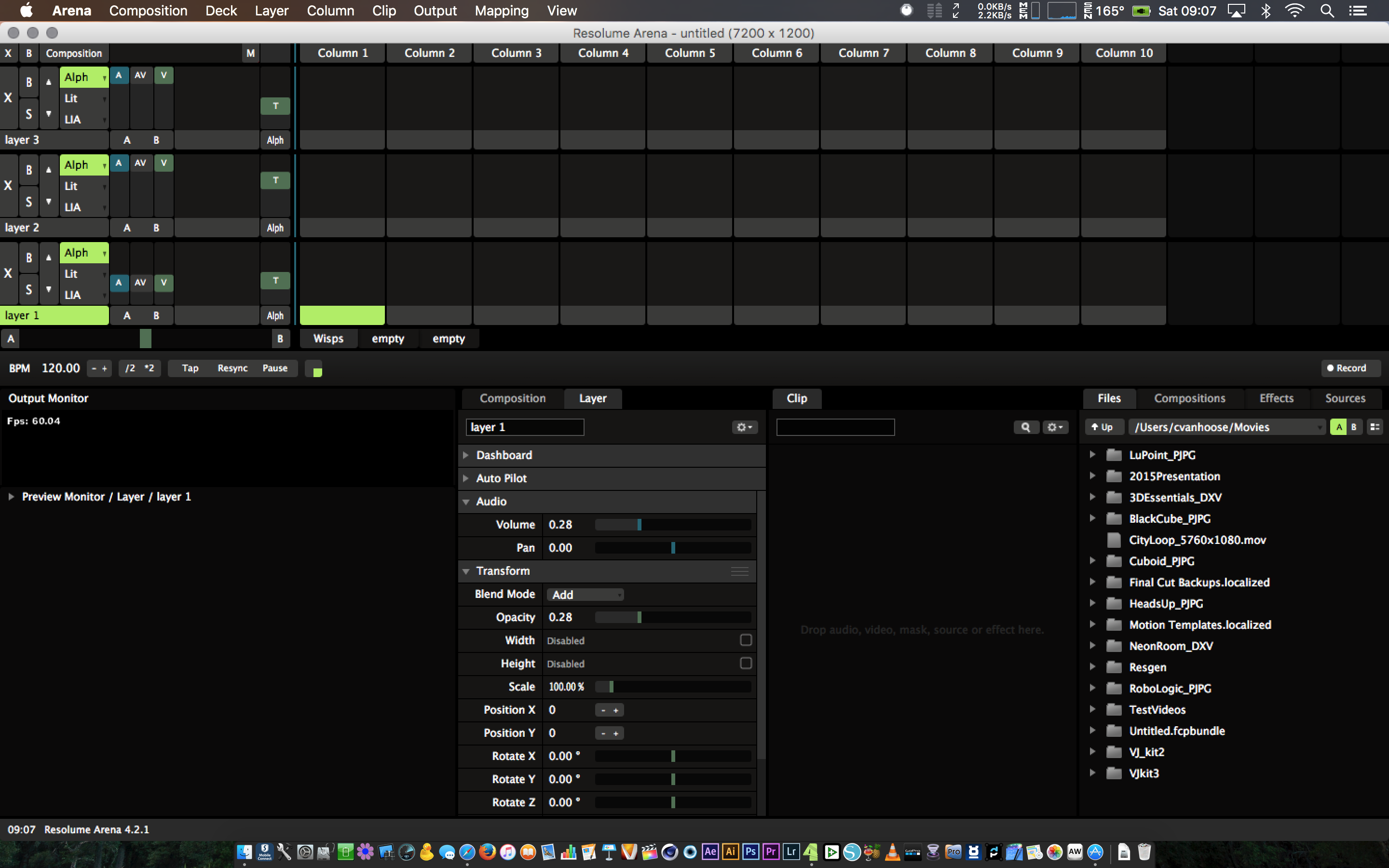

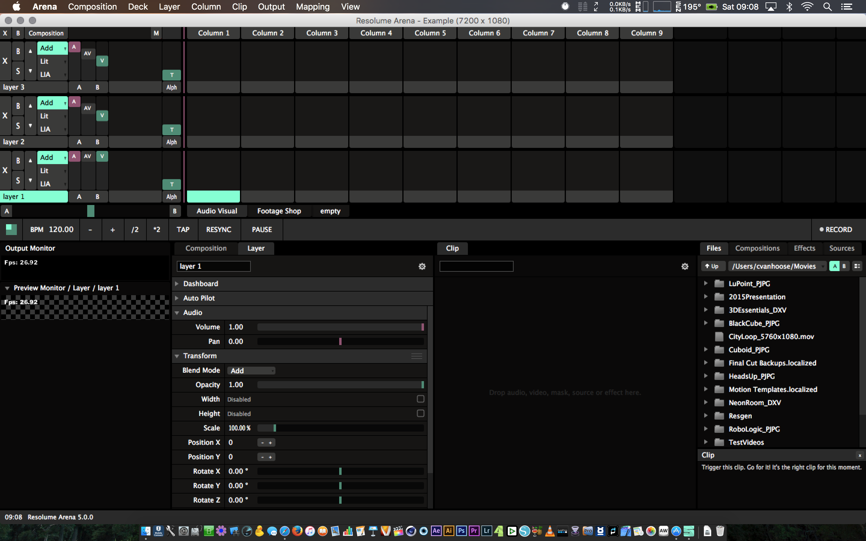

AND....... here is the mac results also.
Existing 4.2.1 install from 6 months ago
4.2.1 installed 6 months ago - retina MBP 15" GT 650M
R5
R5
R5 installed - same machine - retina MBP 15" GT650M

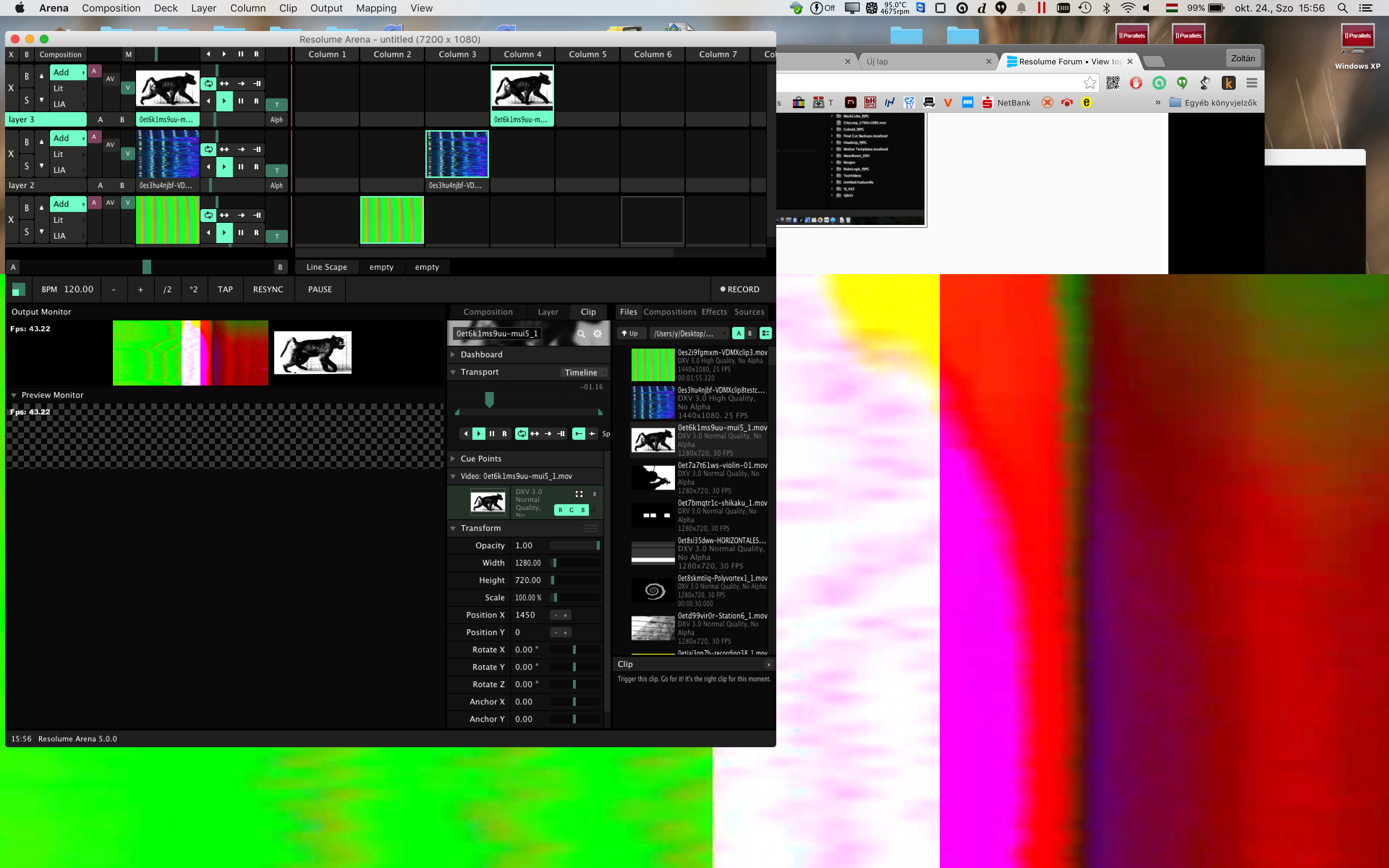

are you using maybe an effect plugin on both machines which is not installed by resolume?
I tried a 7200x1080 comp, playing 3 layers, output to windowed, stable 43 fps on 2012 retina MBP gt650, El Capitan
