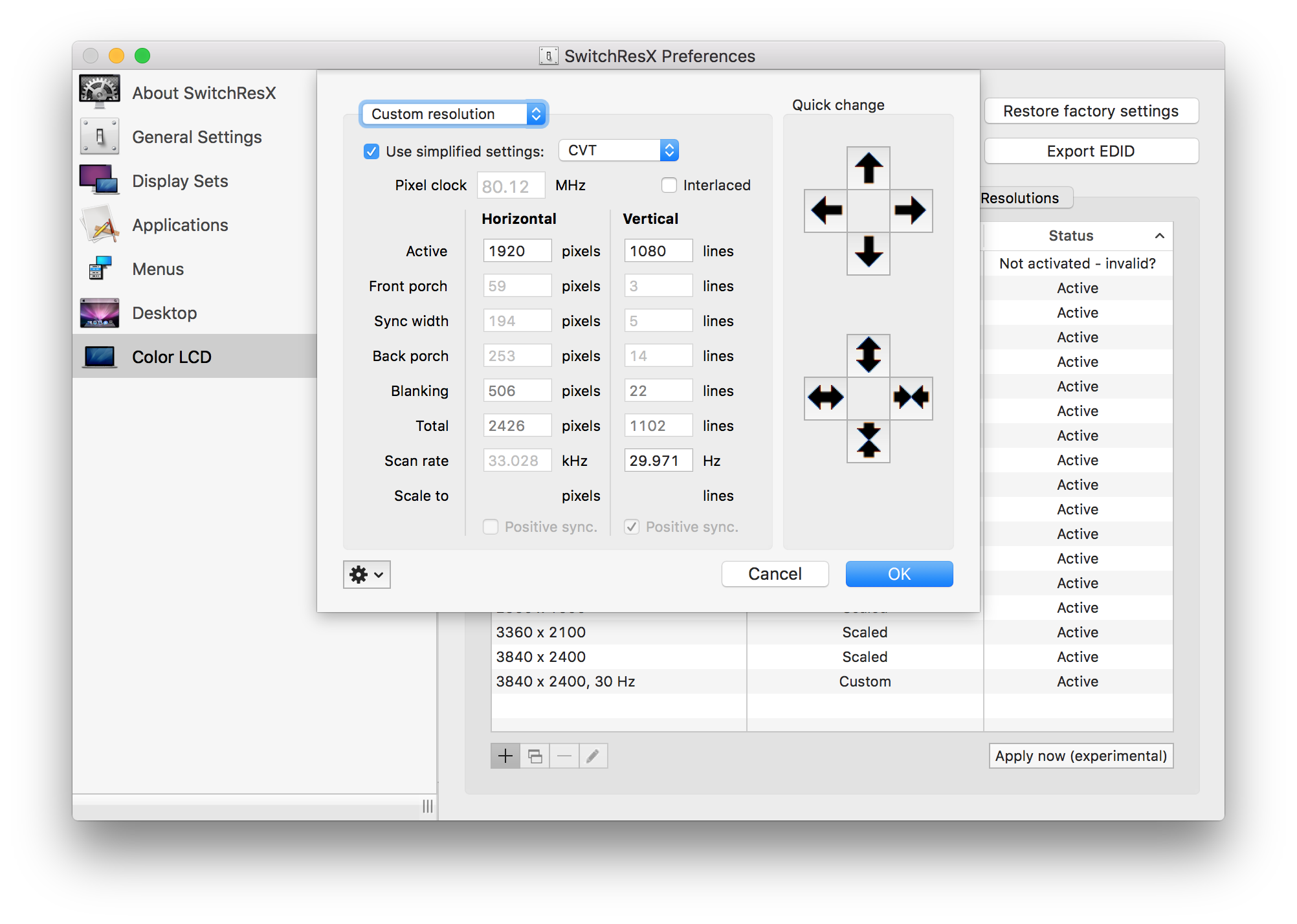

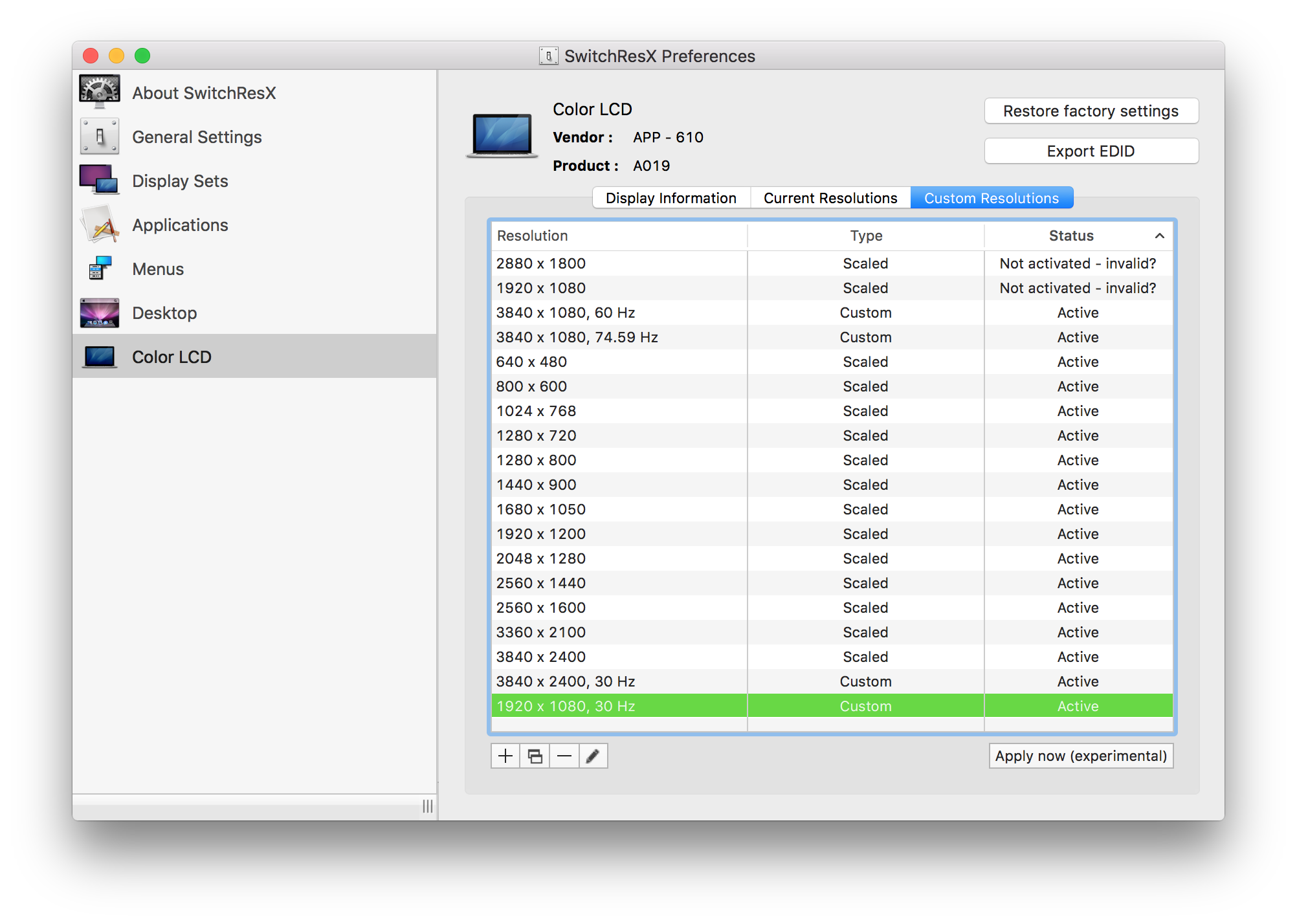

Use ProResX and make your own 1920x1080@29.97 but it will still show up as 30:If Apple were supporting non-integer frame rates (29,97) directly from the HDMI port we would not need this.

I'll follow this advice to solve the question.Oaktown wrote:Use ProResX and make your own 1920x1080@29.97 but it will still show up as 30:

ProResX thanks for reminding me. I'll try.

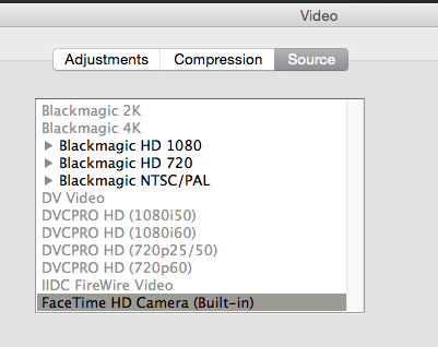

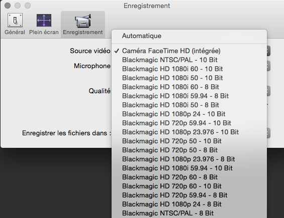

Here are some screen shots of Quicktime and Modul8 showing Mini monitor as input… I did not go any further in the experiment, like actualy trying to use it as source.
No big deal, just strange.
