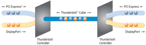

I'm surprised your Asus Rog G751JY-DH72X has a thunderbolt port. Are you sure you don't just have a miniDP output? They look the same but are quite different.
Only the PCIe part of the Thunderbolt cable is bi-directional but DisplayPort is still directional and work as an output. So even if your laptop had Thunderbolt, you'd still have to have a PCIe card (or Thunderbolt dock & adapter) to capture content:

Oaktown wrote:I'm surprised your Asus Rog G751JY-DH72X has a thunderbolt port. Are you sure you don't just have a miniDP output? They look the same but are quite different.
