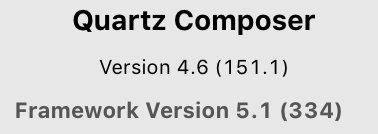

I can replicate the crash on 5.0.2 as well as on 5.1.2,
2012 mpb, gt650m, El Capitan.
Képernyőfotó 2016-11-01 - 10.56.25.png (21.26 KiB) Viewed 14163 times
the crash log is attached.
qt crash.txt.zip
(25.62 KiB) Downloaded 671 times
