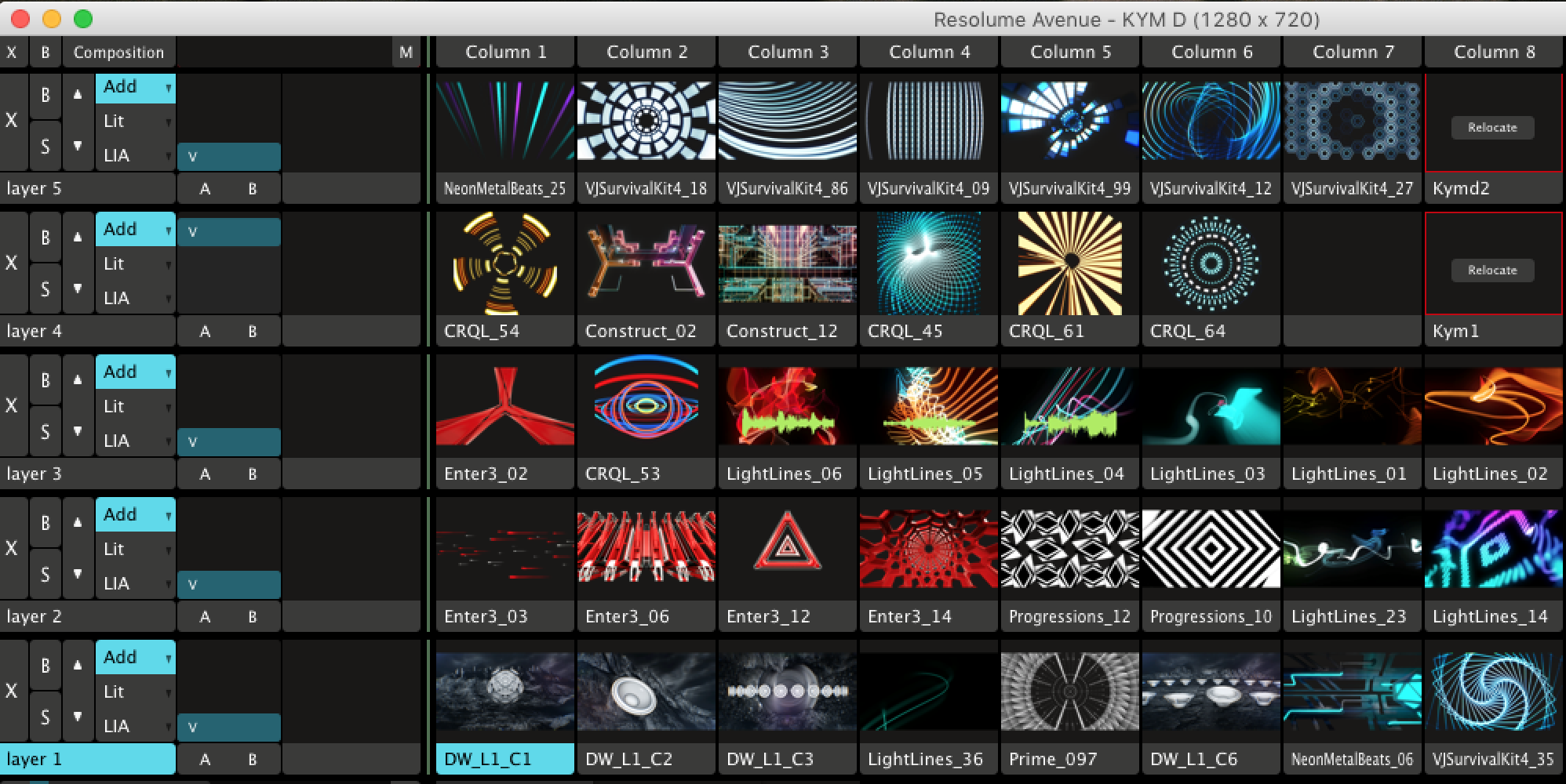

Sometimes I use two 1080p monitors side by side with a Zotax DisplayPort to Dual HDMI Adapter (ZT-MDP2HD) so that I can get more clips/columns on my UI.
That works on a OSX as well but of course that wouldn't work with the native display of a laptop!
Unfortunately, the Zotac adapter has been discontinued but maybe there is something similar on the market that could be used to the same effect.

Single EDID split in 2 halves which is why it let you span two monitors.
