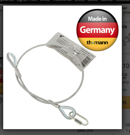

Hi Guys,
I was hoping if someone has personal experience for international production.
I was wondering if safety cables bought in Canada specifically on avshop.ca I guess they are made in China Global truss... are ok to be used in Germany for an exhibition. I haven't seen specific rules but I guess if I use german made cables with certification about load on the cable I will avoid any type of problematic!
Btw I need these cables to take care of the safety hook on my hitachi projectors and on the aluminum shelves on clamps.
What do you think guys? ;)
Regards,
Jo.

Thank you guys, in the meantime I've been in touch with some old friends with experience and did some research. To avoid any country regulations I've planned to buy certified cables made in Germany (they are slightly more expensive) and yes beside the shelves (5kg each) and projector (8kg) bolted with M6 hex bolt, I will individually cable them. One for the projector and one for the shelf. Went through the exhibition regulation and the only DIN are regarding the rigging point for the trussing. I'm allowed a max of 50kg per rigging point. Therefore I've distributed the weight equally along the truss.

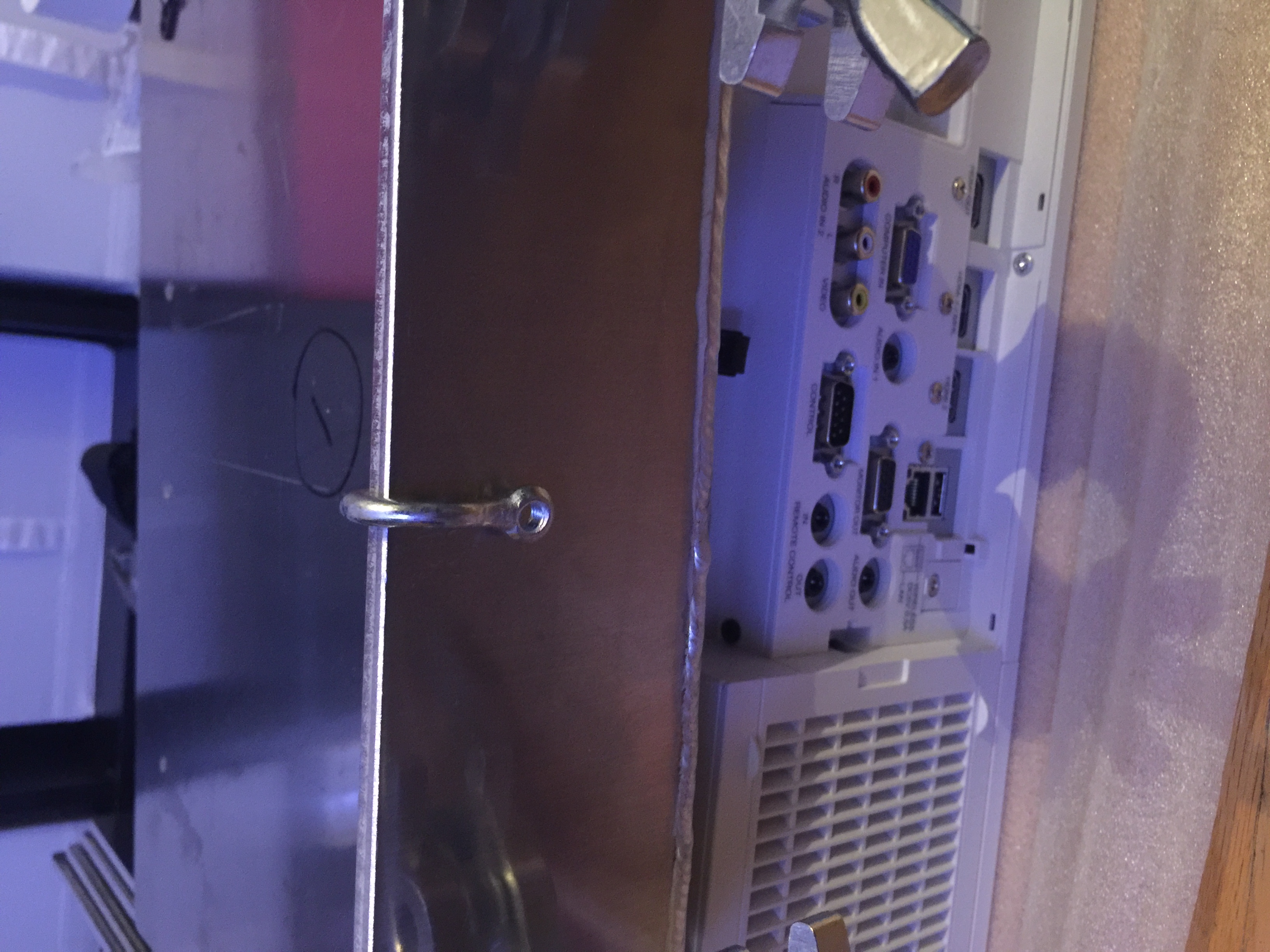

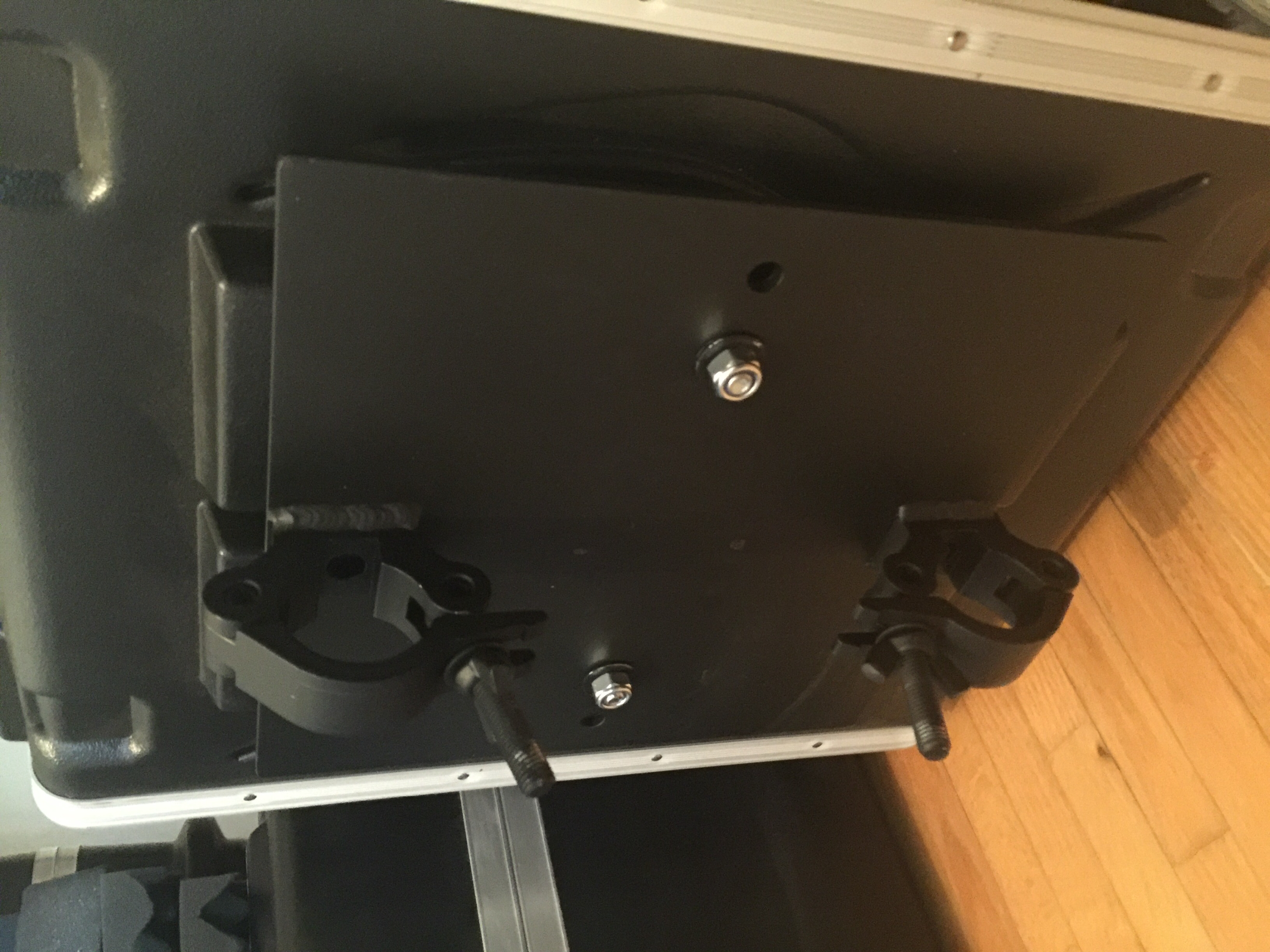

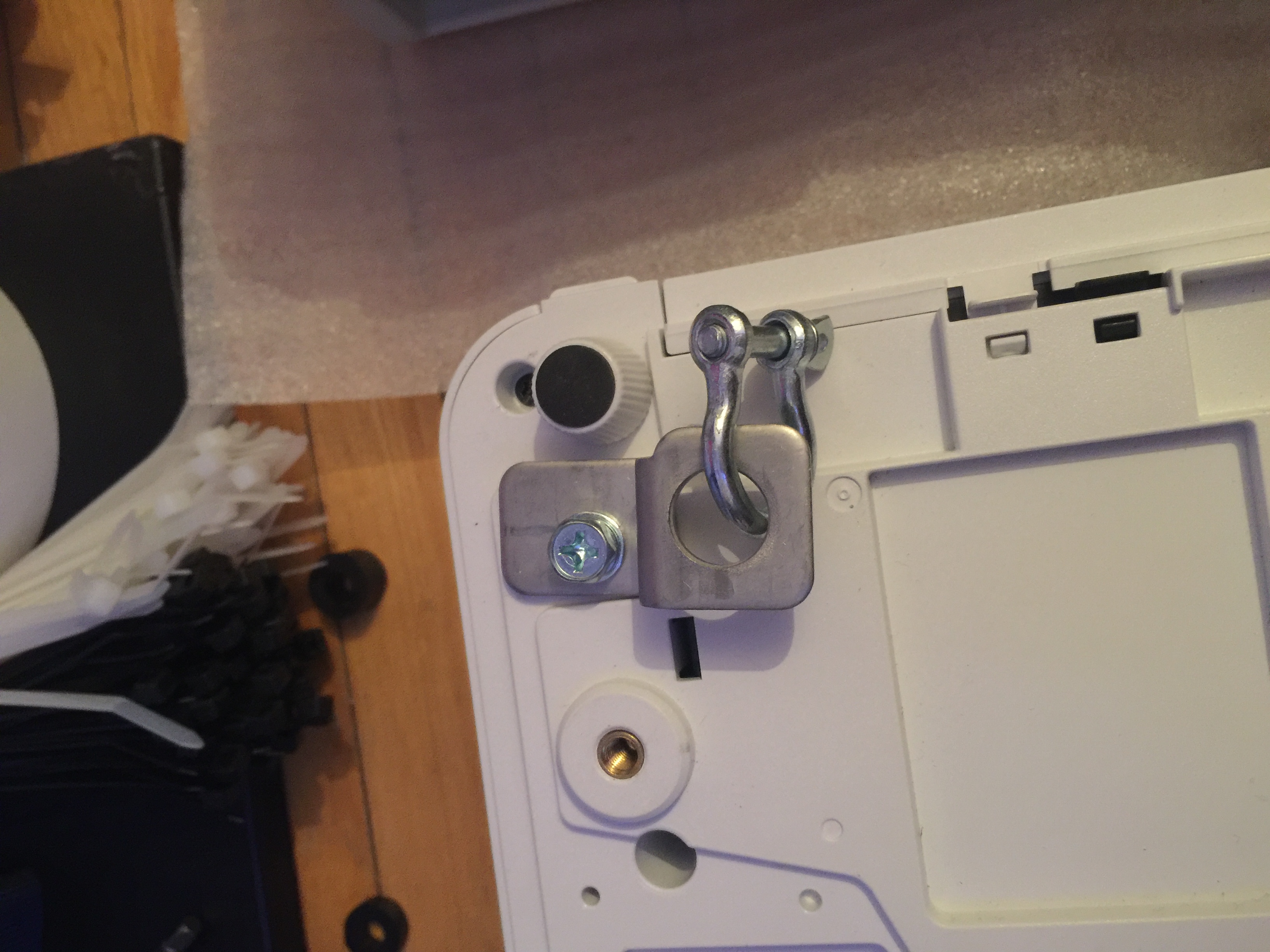

I'm attaching some shots of my shelf and safety hook on the hitachi.
The cables are certified for 10kgs and the clamps are for 300Lbs.
Best,

He2neg
Posts: 951
Location: Berlin, Germany
Re: Safety cables North America-Europe
Post by He2neg »
Happy we could help you.
Importand for the Cables is not the "Made in Germany".
It´s the XX kg follow the rules DGUV 17 / old BGV C1 . Then you are safe.

Thank you, in fact I decided to buy double of the weight for each item and I've rigged my rack and my back up PC tower as well. All the clamps and swivel have imprinted the 300lbs load, and some of them are certified TüV Nord.

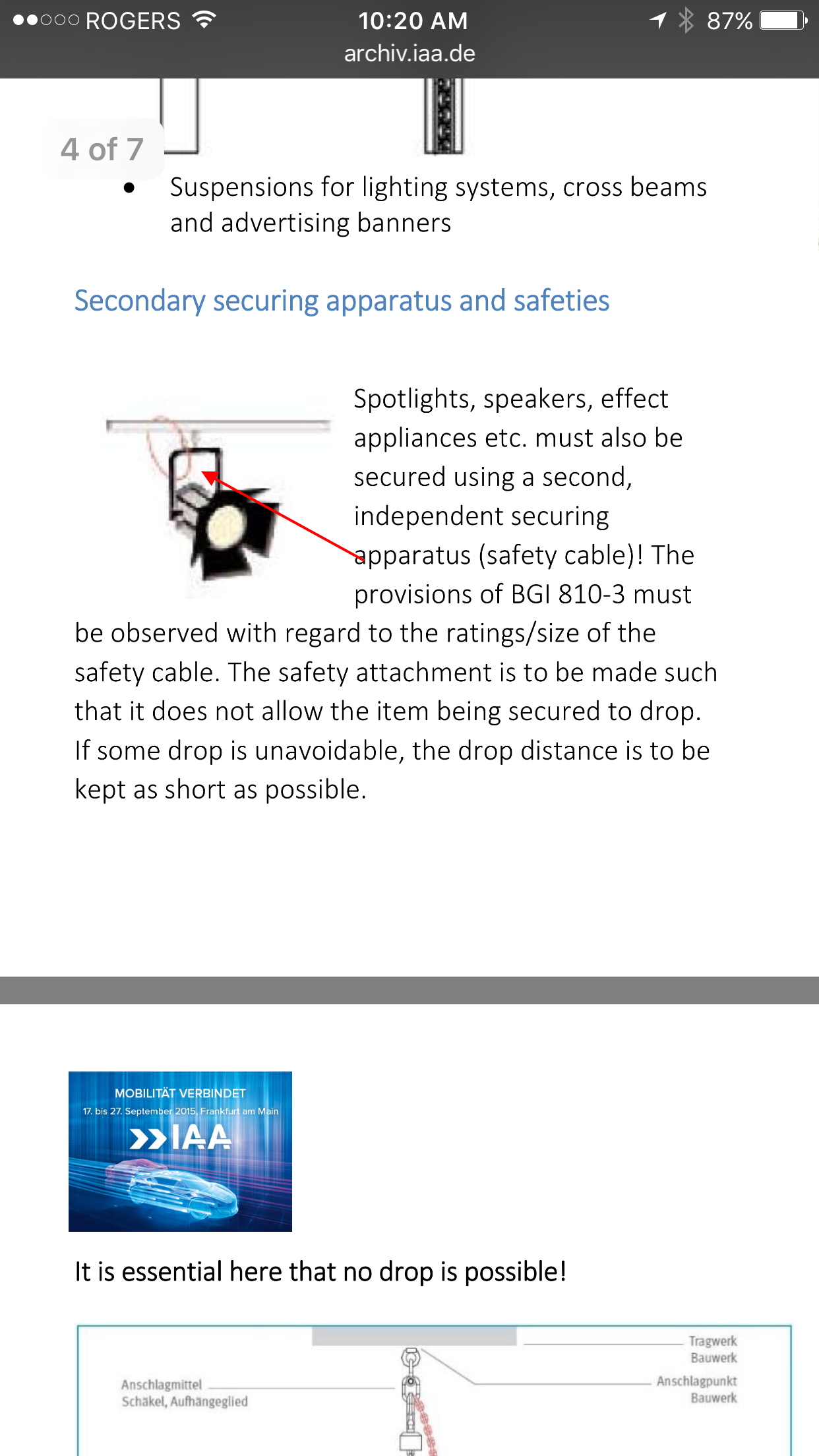

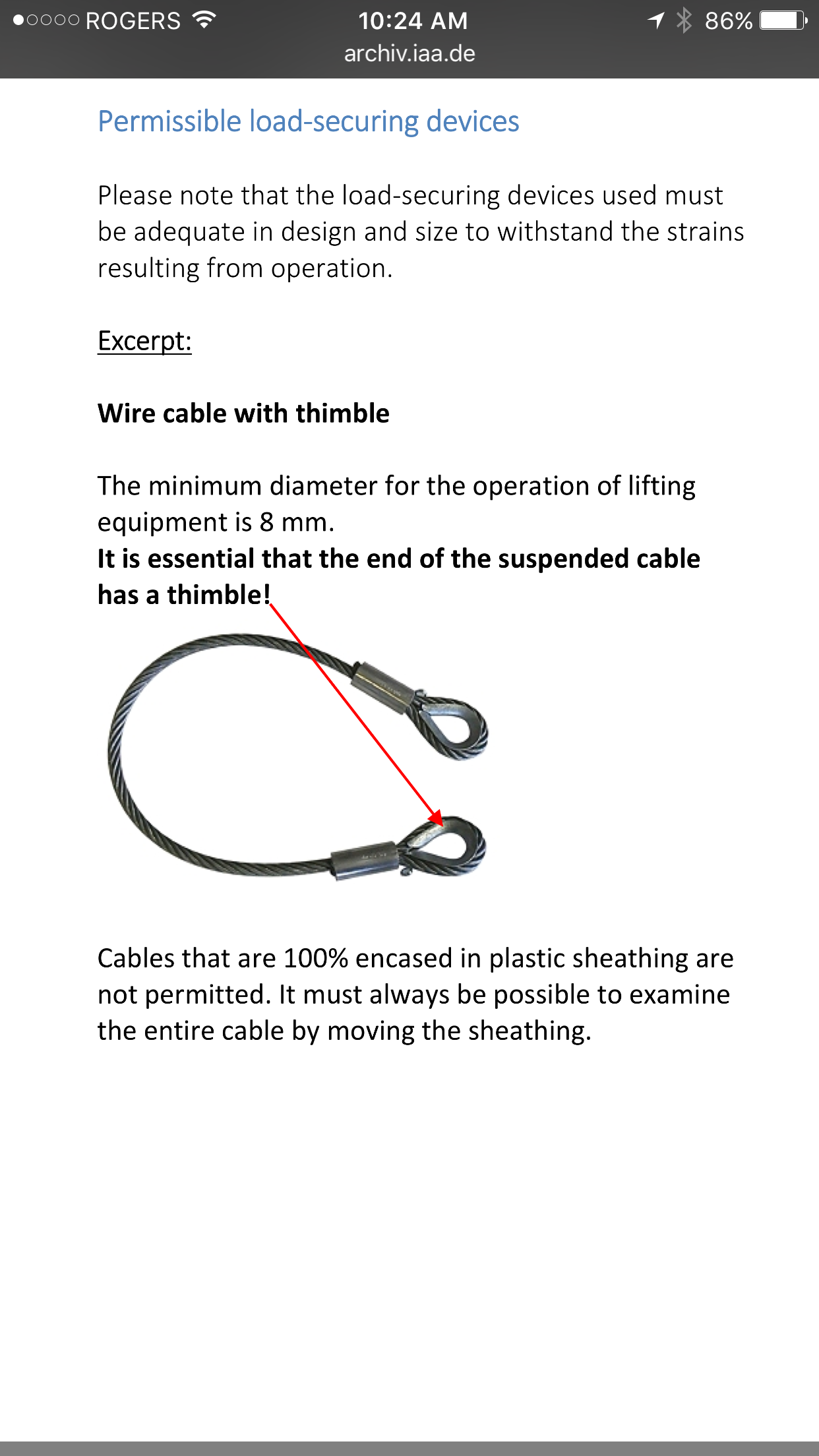

He2neg thank you again,

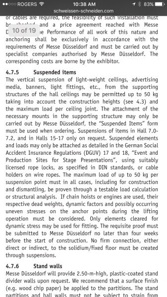

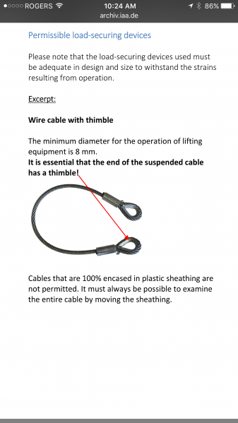

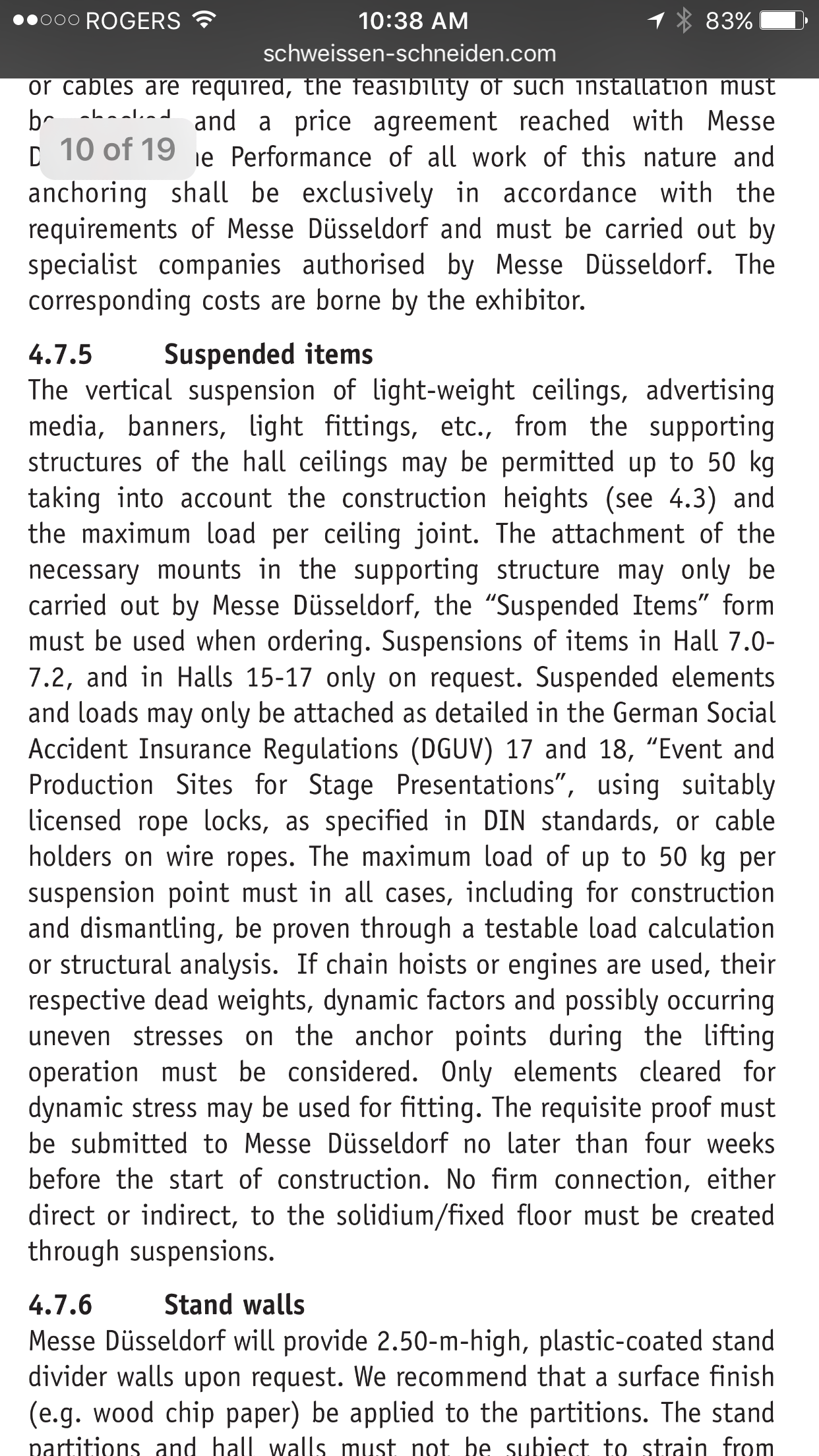

I've done some research and it looks like the DGUV 17 is a requirements for all Messe in Germany but here they are talking mainly for ceiling wiring which is the in house lighting company. I even read that the sweety cable has to be double of the weight, this info was actually on an old PDF from Messe in Frankfurt. The lighting guy was showing a classical projector frame that he could rent for a crazy amount of money of course but I didn't find any specific regulations on which mount I can use on the trussing but only regulations from ceiling to suspended items I.e. Trussing light instead. Therefore if I use my aluminum shelves and bolted projectors individually secured with a certified cable I don't see issue. I'm attaching some screenshot. Thank you I advance for your help, and please feel free to inquire if you need help in regards of regulations in Canada, specifically Ontario and Italy.
