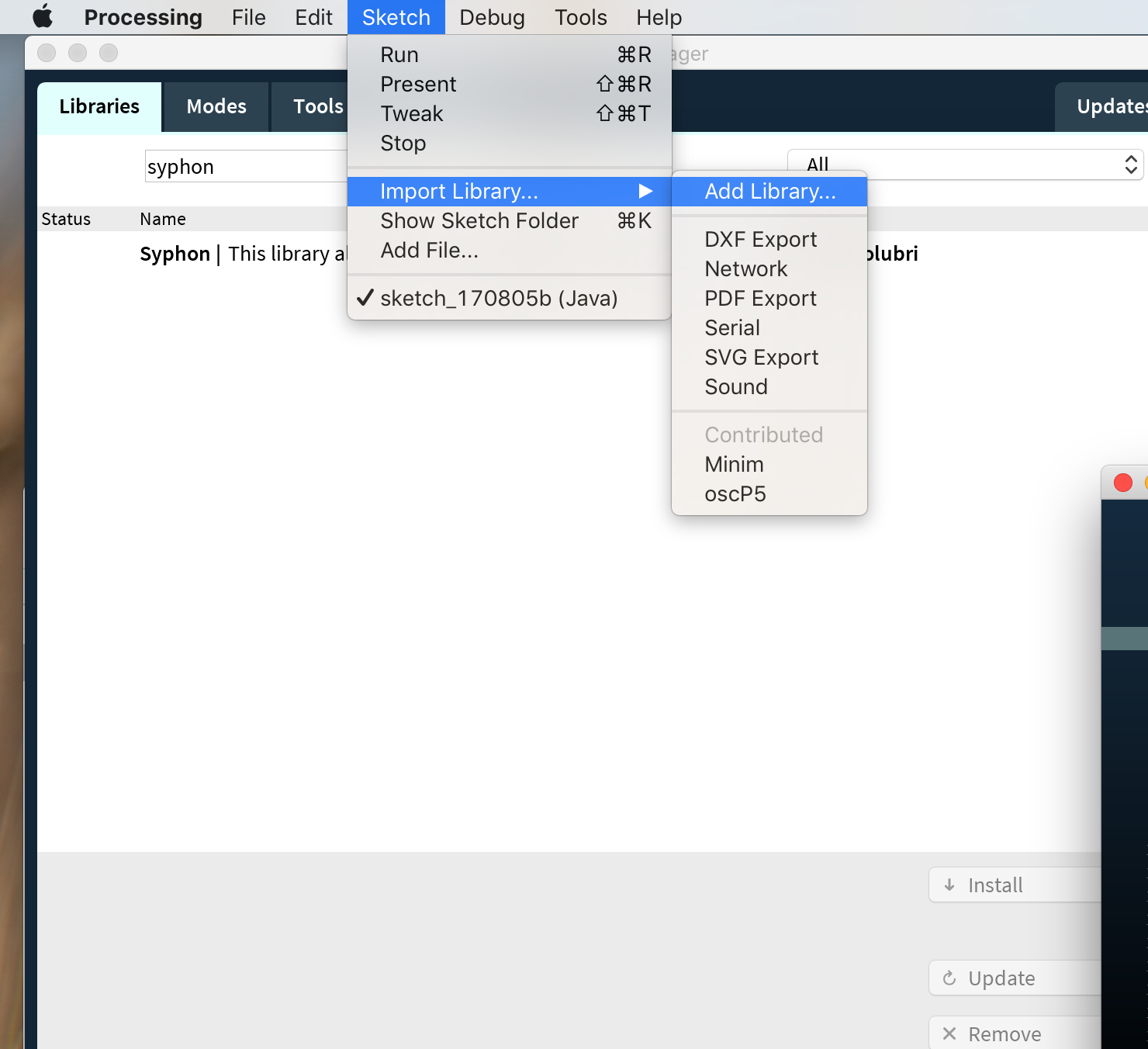

you can get syphon easily thru the built in library manager in Processing

How do i go about doing this? Could you point me in the right direction?
Posts: 7605
Re: Resolume into Processing
https://github.com/Syphon/Processing/bl ... Frames.pde
is an example syphon receiver sketch on GitHub
once you added the syphon library via the manager the sketch should work.
