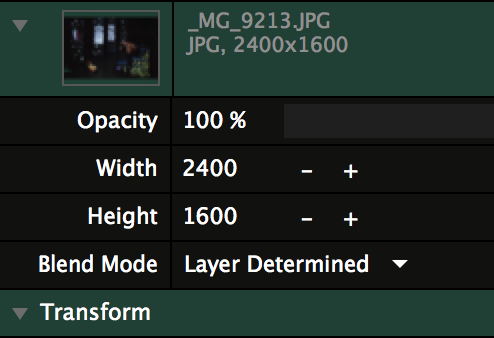

Yeah, you can in Resolume 6,
It's in the clip video track properties.
so actually this below is the layer blend mode that can be set individually not the clip transition.
