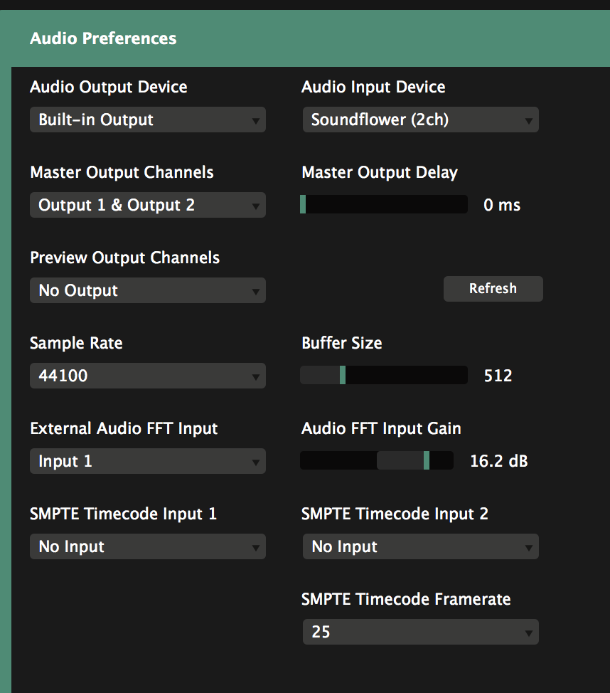

Does Soundflower work to other applications?
edit: got around to install SoundFlower on my high sierra machine and it works fine for me with Resolume 6.0.4
these are my settings in preferences:

I see the same settings under Arena 6 as you do.
