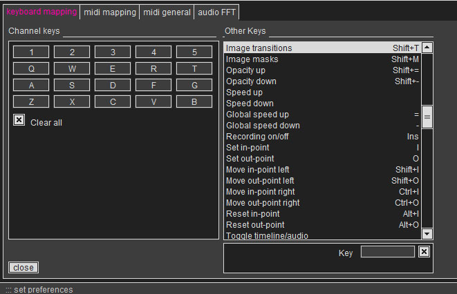

Is it possible to assign 2 keys to make Global Speed speed up/slow down? e.g. + for faster and - for slower. This was possible last time there was a global speed function in R2.x

So just gave the BPM a go, its close but it would be nice if you could hold down a key and it continues to change the value not just on a keystroke and I realised how many clips I need to change (around 1700 decks worth), Is there a way of changing multiple clips to BMP mode at once?
I gave the second way a shot to and its ok but as it only gives a set value on keystroke and not a relative change it wont do what we are after.
We are after a way to do incremental smooth changes to speed for content that has dancers in it to make it look like they are in time with the music.
Hopefully there will be an implementation of keystrokes to faders like it used to be in 2.x see attached.
