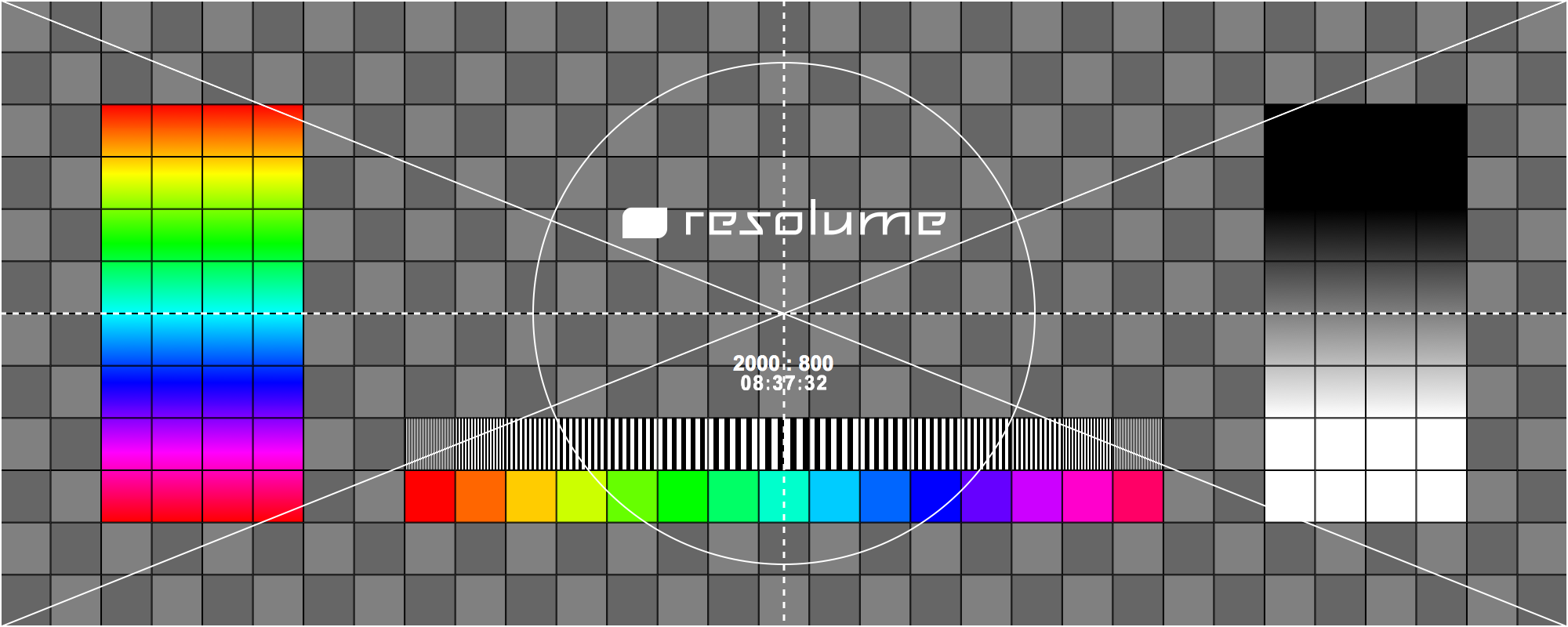

Since Arena 6 has come out, I've had the opportunity to blend and stack many sets of projectors and I must say there are things I don't like about the new test card so here is my feedback:
1) Please give us an option to turn off the sweeping as it very distracting when you're working on convergence
2) Make the grid square a constant pixel number (40 like the previous version is great considering most everything we do is divisible by 40)
3) Center the grid
4) Make the black grid black without "shadow" so that we can have clean edges
5) Give us more circles and color/black&white on all sides so that it can be easy to line up and color match projectors

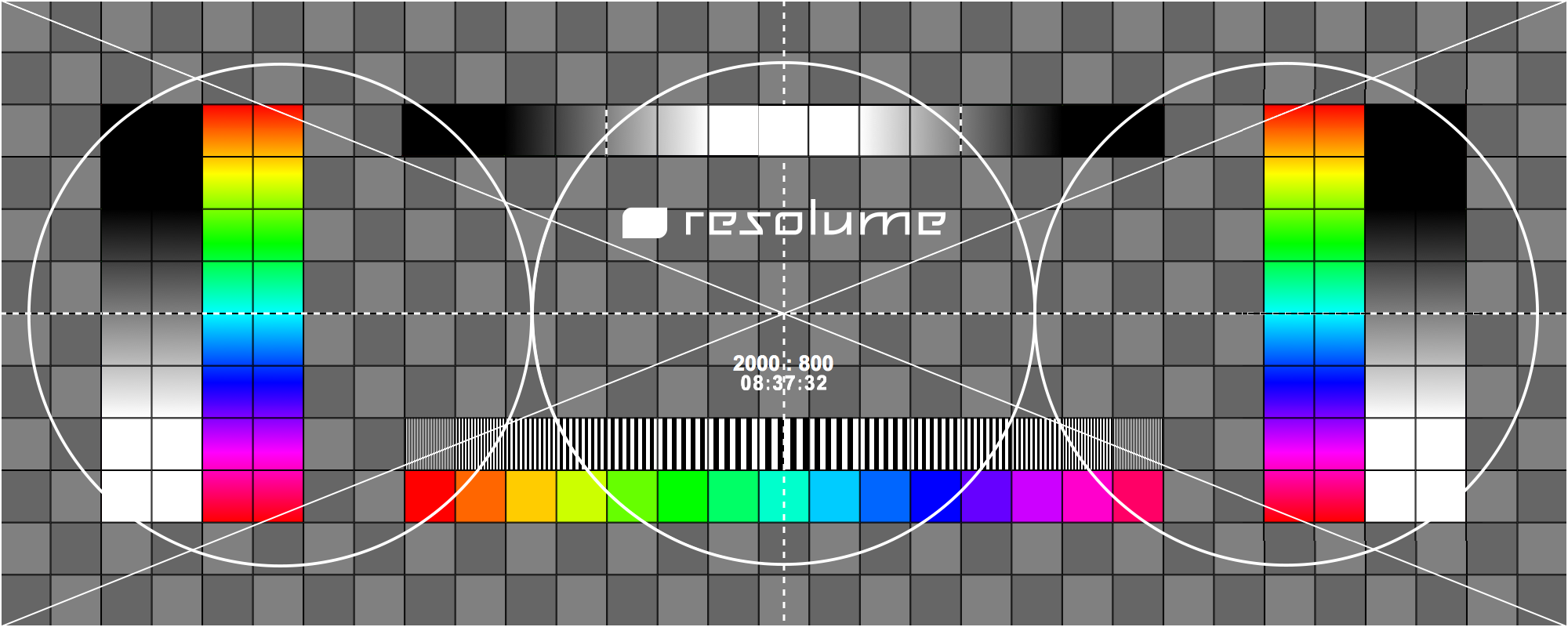

In addition, I would love to have the ability to generate test cards for slices
The following modified test card doesn't have the 40x40 clean grid on center but this is just a quick photoshop version to show what I'm talking about in comparison with the current one:
It's really hard to focus on converging and fine adjustment when the white sweep comes on.
I need a constant frame of reference
3) Center the grid
For me it's important for the dotted lines to bisect the grid in quarters.
Having the 'shadows' make it difficult to accurately blend projectors
Having multiple color/black&white areas help with color matching multiple projectors. Lines are great but circles really help in checking for linearity in both directions.
