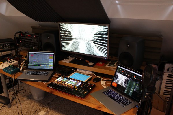

First, I have my midi controllers, the APC40 and Lemur on iPad, and sometimes the Novation Launch Control XL, mainly for when I’m doing surround sound and/or Aether live shows:
In addition to my usual visual set up, I send midi control information into Ableton in order to launch clips, trigger percussive sounds, work with glitch effects, delays, reverbs etc., and to work with EQs and filters – all the normal Ableton live controls. I also send midi to Ableton for some visual-only controls, such as my effects matrices, whereby I can assign any combination of many different visual effects to link to the filter cut off frequency of one particular filter, for example.
All of the visual controls for my live show arrive via Ableton and OSC over ethernet cable, whether they actually do anything to the audio or not. This allows me to continually work on the audio-visual interface, so that I can constantly try to improve the link between the audio and visual.
I’m always thinking – “OK I want to do this particular glitch effect or audio transition with a delay, or whatever, but how should that particular sound, look?”
Then, the next challenge is to figure out how I can make it work in Arena.
Luckily for me Arena, has a lot of effects and modulation options, so I’ve managed to find some nice mapping techniques which are in line with the concepts I’m trying to show i.e. how simple building blocks come together to create complex beautiful outcomes i.e. emergence. This is a very old video about this, but hopefully still relevant:
There is another, more practical, reason why I send all my controls through Ableton en route Resolume, which is that I can use Max for Live devices to map the control curves – it may be that I want a particular graining effect to come in as I filter in a sound, but maybe a 1:1 mapping of the filter cut off to the grain fade parameter doesn’t quite work. In fact, what I found was that 1:1 mappings rarely felt natural. So, I use hundreds of Max for Live devices for changing the mapping correspondences.
Sometimes a straight line needed to map to a shallow, or sharp, curve; or map to a limit less than the highest value on the receiving end. I use Max for Live’s old API tools for these jobs, although there are plenty more parameter to parameter tools out there which do the same sorts of jobs, some where you can draw in the correspondences yourself. I spent ages on this side of the set-up, trying to create something I could jam with just like I was playing an audio-only set, with my usual glitching and chopping approaches, but whereby the visual would also follow in sync and in style.

I’m using Lemur to trigger glitch sounds like live drumming, and each different sound triggers a different visual effect via the pathway from midi controller to Ableton Live, to OSC trigger via Max for Live mapping devices and the Resolume Parameter forwarder over ethernet cable between the two laptops.
Then, I also have filter cut off frequencies on glitch sounds linked to glitchy audio effects, so that I can smoothly introduce audio-visual glitchyness in addition to the sharp glitchyness of the live Lemur drumming. And I can assign many different combinations of visual effects to a single filter cut off frequency, so that I can do similar audio glitching with very different visual glitching effect.

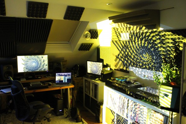

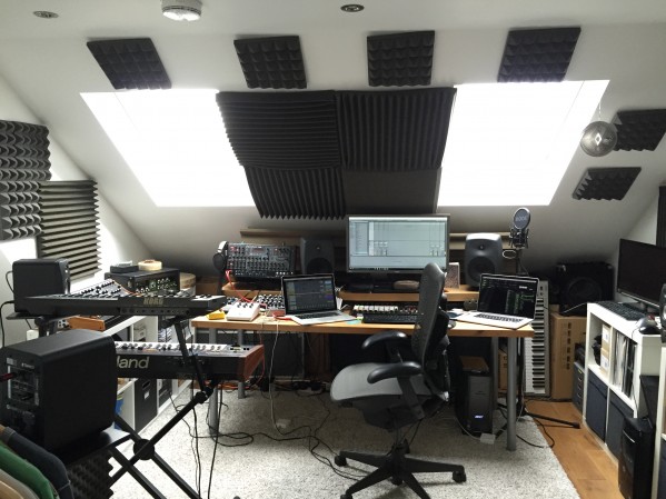

Tell us about your Studio. What’s on your wish list & anything in there that you would like to change/ upgrade?
At the moment, I’m all about my Dave Smith Instruments and loads of random guitar effects pedals mainly. I used to do everything digitally though so I’m not on the analogue bandwagon, just enjoying the wagon for now. My staples being the Prophet 6, the Prophet 08, the Juno 6, The Moog Sub 37, Moog Miniature and still plenty of Henke’s trusty Operator for soft synth sketches, and plenty of NI software – Absynth, Guitar Rig, Razor etc.
Pedal-wise, I’m loving my Fairfield Circuitry units I discovered on a recent Montreal trip, and have been putting the Meet Maude and Shallow Water to lots of use.
I love the classic Roland RE201 space echo tape delay too, and the Moogerfooger Ring Mod and Midi Murf. And for full on analogue pedal mayhem the Industrialectric DM-1N and Echo Degrador, and the WMD Geiger Counter. And the Strymon Big Sky for a beautiful Plate reverb simulation.
As for what I want to have – a Jupiter 8! But I can’t afford it, it’s got ridiculous how much they’re going for. So, I’m mainly focused on finding unusual pedals and experimenting with pedal combos.
My most recent upgrade was the Genelec 8050’s from the 8040’s, they’re lovely monitors in my opinion, nice and full and soft and round, both physically and audibly! That’s why I upgraded directly to the next model.
