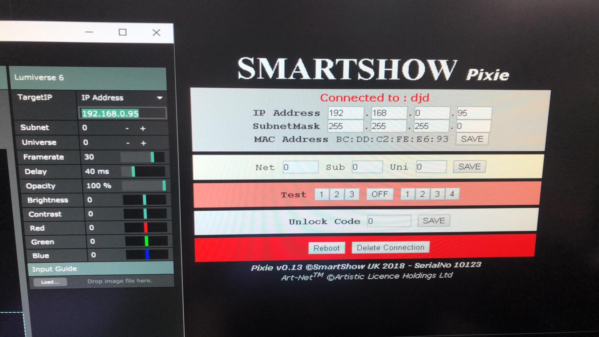

Hi Guys - I have a Smart Show Pixie - which is a (arduino?) based 2812 LED driver.
They recommend testing it with a PC app called Jinx! (madrix, but free). And my current set up works.
With Jinx, after patching - I click "start output" and the blue LED on the unit turns off, and the LED strip turns on.
I don't know how to do the equivalent of that for Arena. I have it all patched correctly, but I can't get it to "start".
Any ideas?!

Re: Wireless LED Driver
That all looks correct.
Two things to make sure:
- You've set the correct network adapter in the DMX tab of the preferences. This should be your WIFI card.
- That no other app is using the Art-Net port. So close all apps that do anything Art-Net related, then launch Resolume and do your thing.

dammit -
that was the fix. I had to switch to wireless adapter - which seems backwards to me. Thank you.

Sounds like all your gear would be on the same network.
Check the IP address ranges your devices use, and make sure they are on the same subnet/mask.
Looks like this should be 192.168.0.xxx with subnet mask 255.255.255.0.
If you use a DHCP server on the router, make sure that it supplies also this range, and it has an IP address of it's own in the same range so you can adjust things more easily.
Also make sure the Router is set up not to segment the Wireless devices from the wired ones.

I think this thing might be creating its own network that the laptop connects to. But it's all guesswork at this point, which is why I recommend to get in touch with the manufacturer about advice on the network setup side of things.
