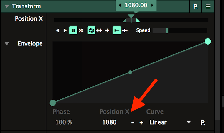

I decided to map my midi controller to the position values in layers.. so I can move clips in real time -
I do a lot of waterscreen shows and the waterscreen spray moves sideways in the wind...
I can adjust the sensitivity of this by using the envelope - fantastic..
would be great if I could type in values for the envelope rather than just dragging buttons, so I have more accuracy - I'd like to be able to have the middle value of the MIDI controller the middle of the screen and the envelope be the edges of the screen.. so in HD that would be +1080, -1080??
thanks
Posts: 7651
Re: envelope values..
7 bit midi won't give you much accuracy with the position, but you could
try setting the position param to timeline, and paused, so you can set the end points of the param to the range you want.
When you click on an envelope keyframe you can enter the value position for it by typing, or clicking the + - buttons here:

ah perfect thanks..
I don't need fine adjustments, just to move the composition output on the fly..
