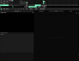

Re: text resolume 5 to 6
Posted: Mon Jan 28, 2019 09:20
by Zoltán
