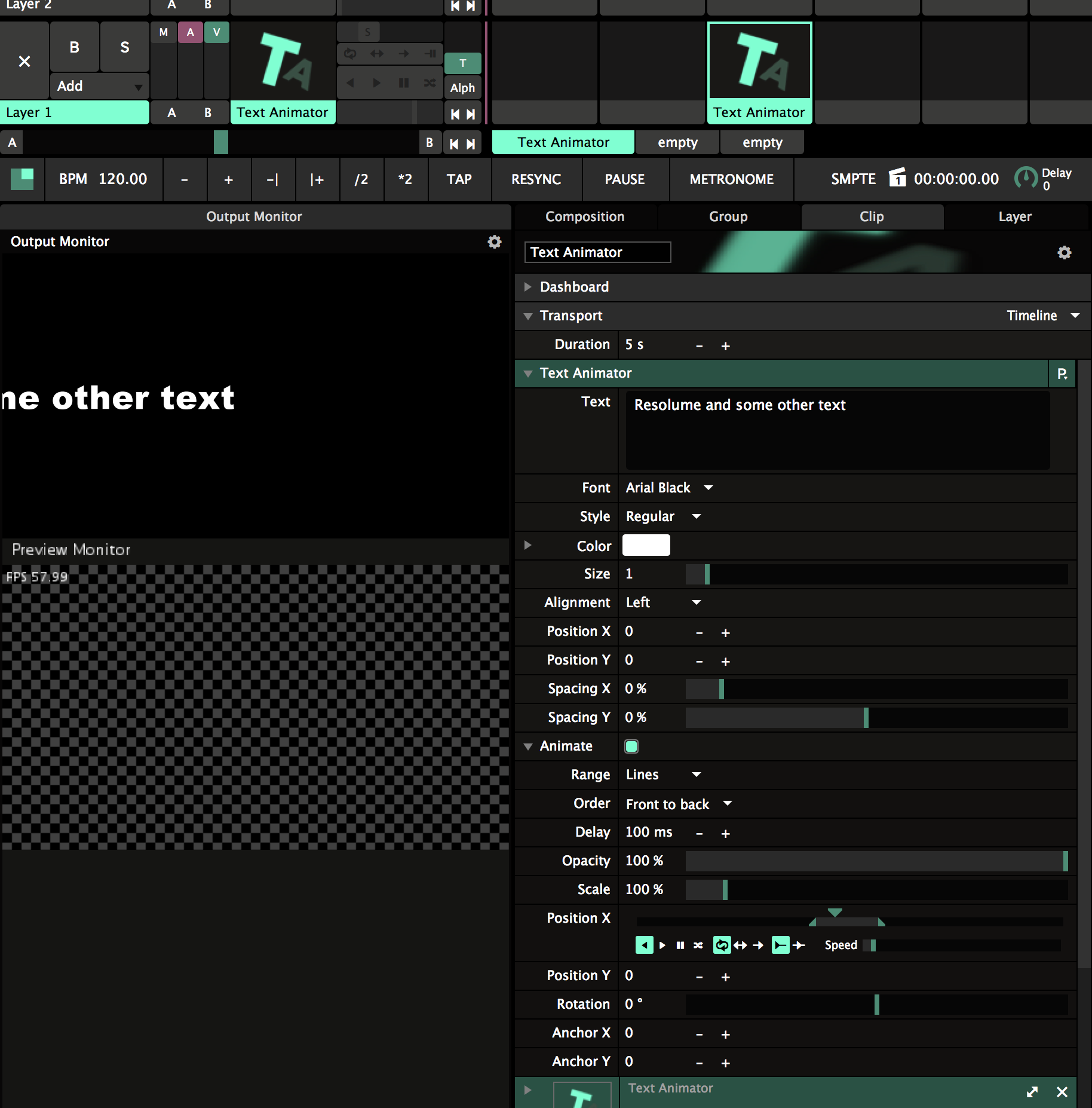

Posts: 7771
Re: text resolume 5 to 6
Try enabling Animate in the Text Animator with your text in a single line, and play around with animating the position X or Anchor X params.

can you make a movie of it.
have been working on it for a few days but I can not :cry:
Posts: 7771
