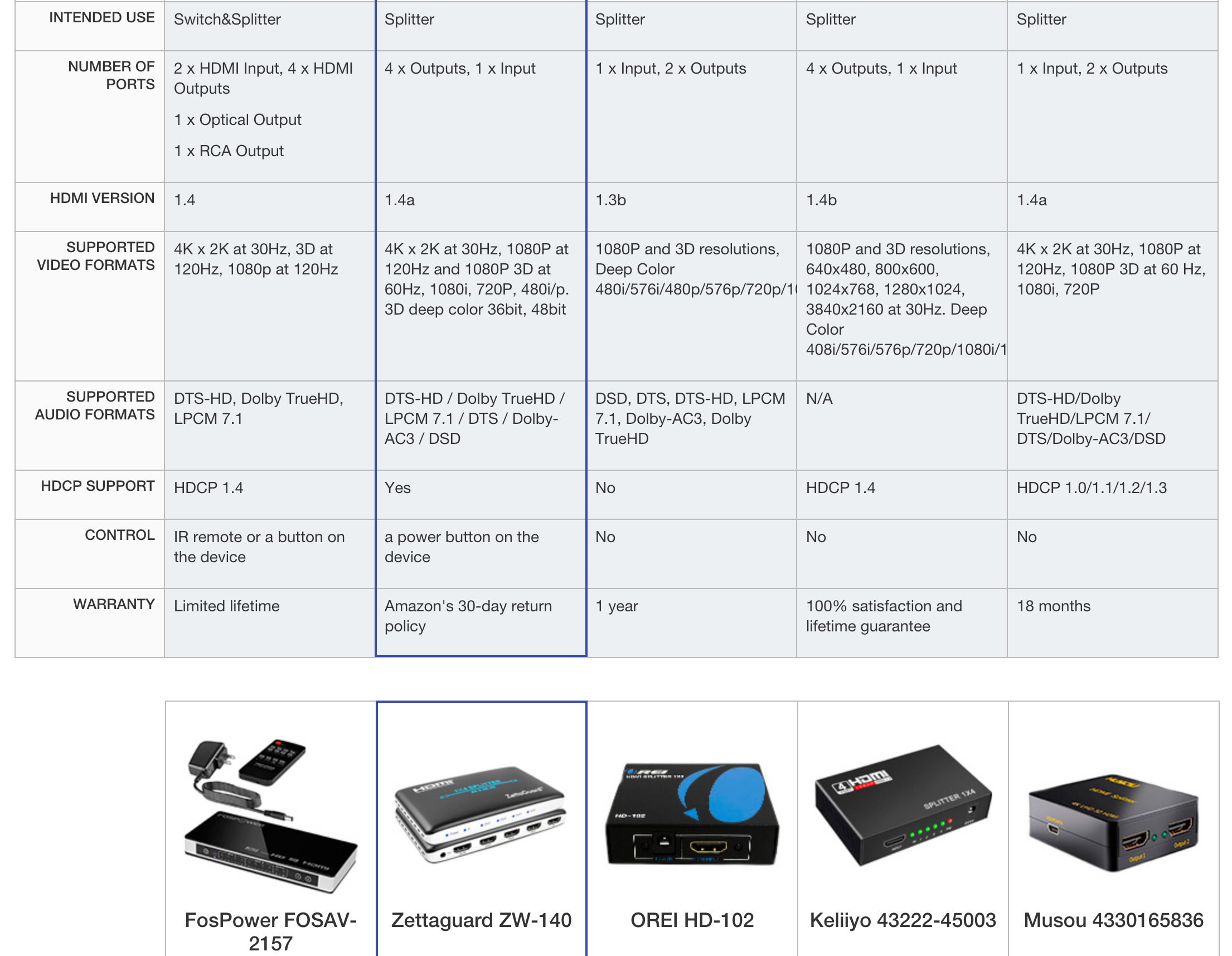

As I understood, they carried me to a separate topic, therefore I will add. I understand that much will take care of the quality of the splitter, here are 2 variants that I want FosPower FOSAV-2157 or Zettaguard ZW-140. So, the first has many ports and HDСP support, the second has many video support formats (URL moderated.) Based on these variants, the question remains the same)

They are close by, the video card from Nvidia 1060 TI
Two monitors for montage, one for entertainment during the render

A splitter will just copy the Signal you Input to as many Outputs as it got.
so Signal A will get A´ & A´´ & A´´´
All the same Image....
What you need is a different tool. You need 3 seperate Screens so your GFX Card will have to render 3 independent signals.
A & B & C

But what about the screen expansion function? and what about the tool?

How many outputs are spare on your 1060 card? Do you need more outputs? Or just a couple of adaptors.
To get more “output” from a single HDMI socket you will need an output expander, for example a Triplehead2go or my favourite, a Datapath X4.
Simple HDMI splitters will just give you multiple copies of the same information.
I’m not sure what tools you’re referring to in your last post.
