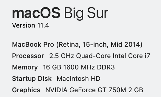

Same exact issue for me, but I am on a Mac.
I tried deleting the prefs, didn't work. It was working fine yesterday, but today just crashes non stop and I can't open the app. It's frightening
Attaching my computer stats as a screen shot.
