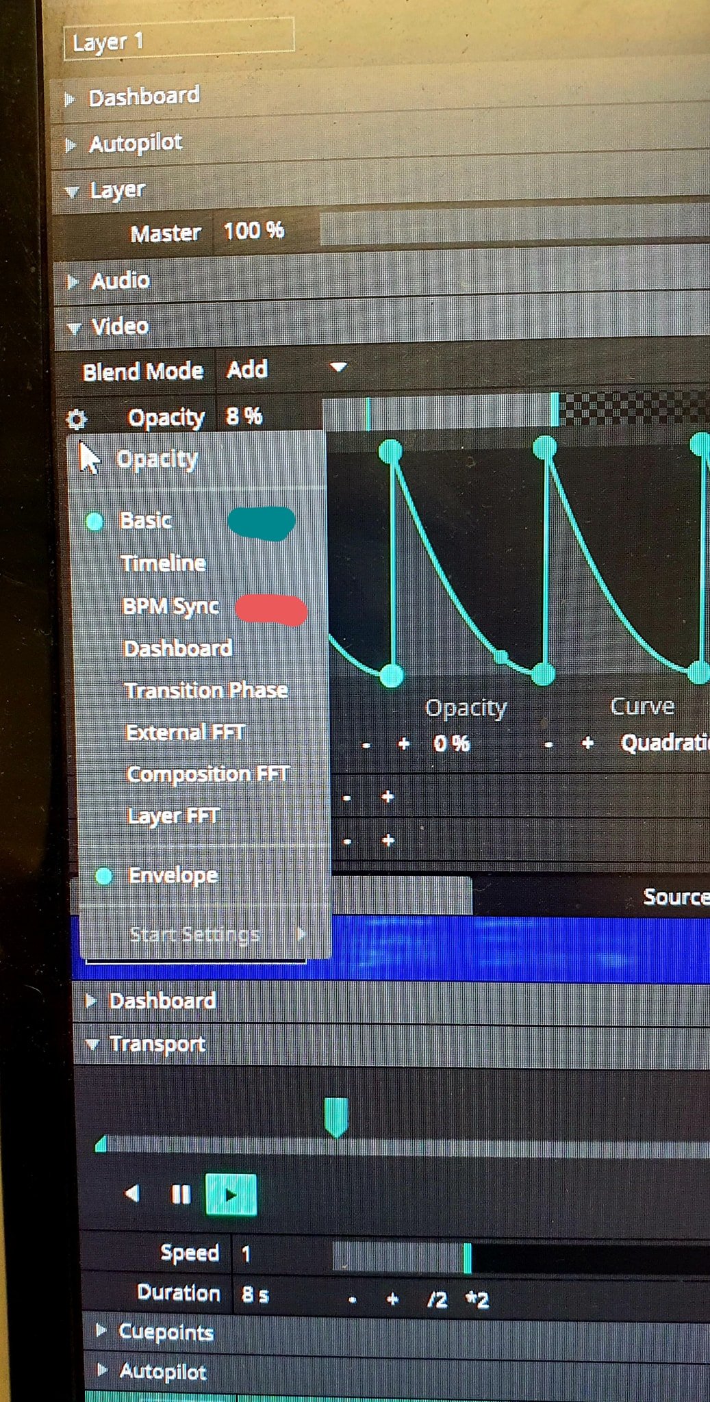

I am trying to midi map the change between BASIC and BPM SYNC on the opacity of the layer. (see attached)
I want to be able to BPM sync the opacity so it bounces to the beat, but then I want to hit a button to regain manual control of the layers opacity
Is there any way to midi map this?

How about mapping the pause button on the parameter?

That worked! Its a bit of a workaround, but the result is what I wanted.
Thanks so much.
