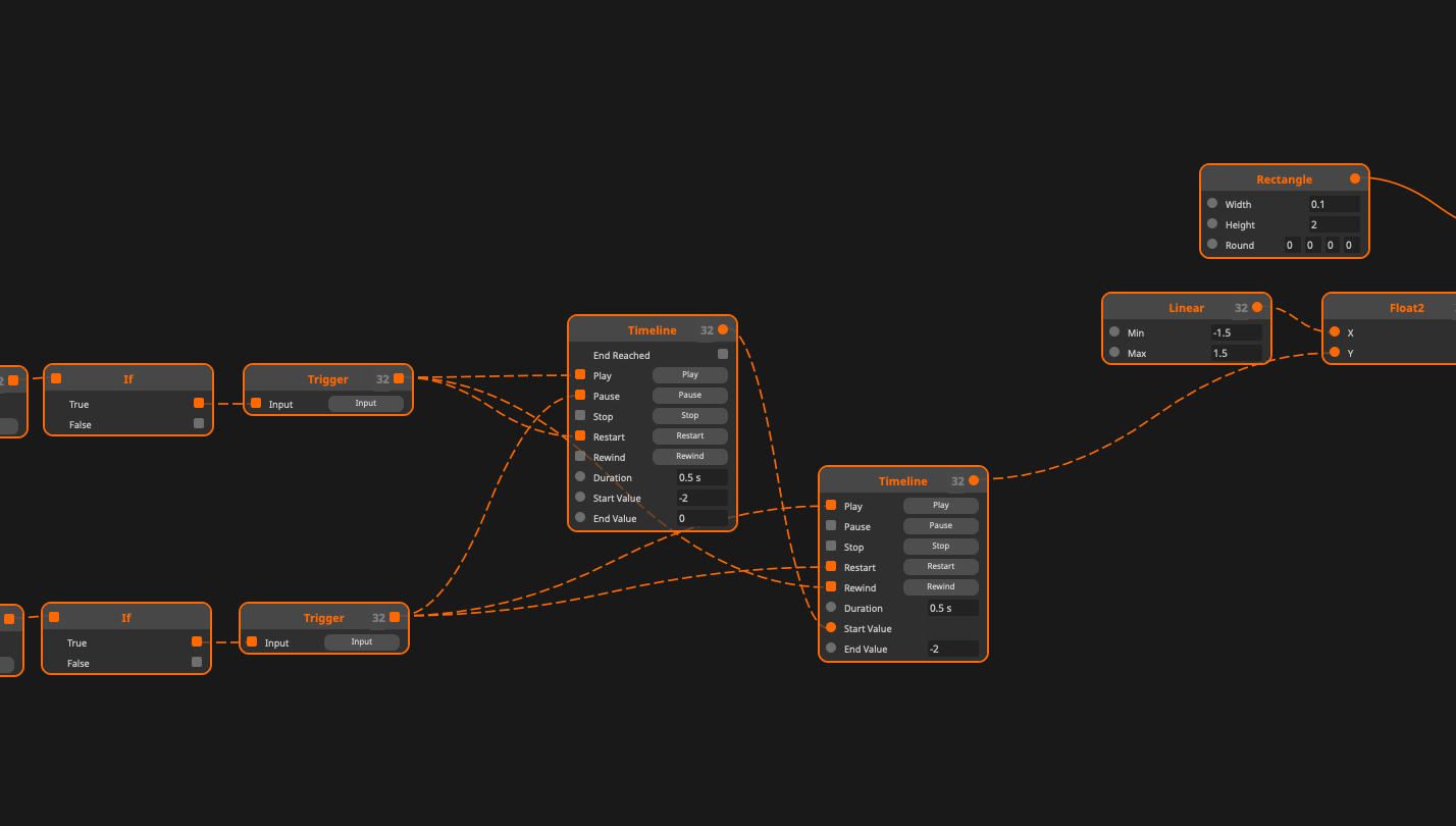

I'm still struggling with controlling instances. :?
What I'm trying to do is to start an animation on noteon, and reverse on note out, this works now but when pressing a lot of buttons at the same time the note off events are regularly missed. :shock:
Maybe some of you experts could take a look and maybe give me some cleaver hints how to deal with this kind of setups?
