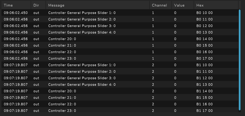

Hi there,
I'm getting started with a MIDI contoller and expecting some trouble right now. (Also I am a newbie to MIDI.)
The buttons at the bottom row (note 1-8/D#2, see picture attached) which should control the channels selected are not reacting in Resolume (7.4.1) - or at least only for a few minutes after starting Resolume sometimes. As long as they are assigned to something (e.g. layer select) they do as they told.
(There also was a thread allready explaining the channel mapping: http://resolume.com/forum/viewtopic.php?t=11655)
The following issue is that I cannot control the device knobs for channel 2-7 as only channel 1 is active all the time. Somebody knows anything that is interfering maybe with the channel selection? Can I assign a MIDI channel selection to a button only (which should happen automatically I guess)?
In the Resolume MIDI Preferences I can see that the signal is actually being processed when I push a button. In MidiView it looks similar (picture attached). Changing Middle C from C3 to C4 doesn't affect anything.
My goal: Having a layer selection via different channels, controlling layer specific effects with the 8 device control knobs and the master as channel for composition effects. This shouldn't be this difficult.
Thanks for help!
Schmarian
