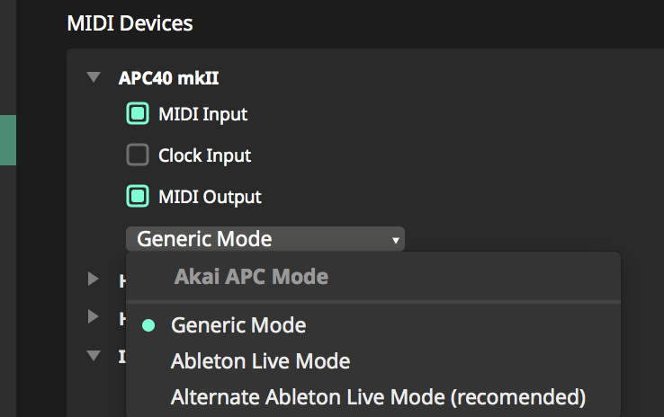

Try to set the APC device in midi preferences to Generic mode.
Though this only changes the right side knobs for me to send on the selected channels.
Re: AKAI APC40 MKII Channel Problem
Thanks, this worked perfectly fine!
