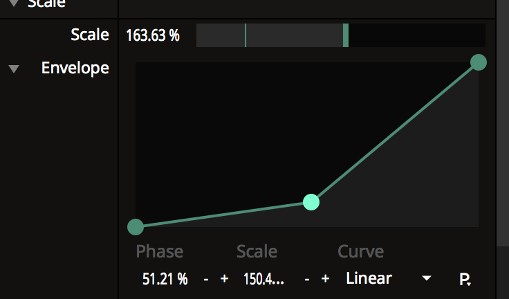

Maybe with envelopes:
https://resolume.com/support/en/envelopes
Set the middle keyframe to the param's default value

Aha! This totally works! Amazing!
I was really confused for a while, because although it was working correctly, the V slider for the layer wasn't actually showing the Opacity value. Perhaps a bug?
But regardless, it works exactly as I want it to! I'M HAVING SO MUCH FUN!

With an envelope enabled, you might see two green lines on the param slider.
The bold one is the parameter phase, the slim one is the actual param value.
With a linear envelope, these are at the same positions.
Midi shortcuts control the parameter phase.

What I mean is on the big V slider that I see to the left of the Layer, sometimes it is showing a non-zero value when actually the effective Opacity is zero - so I found that a bit confusing and thought I was doing something wrong. :)
Posts: 7710
Re: How do I have MIDI inputs only affect in half of the range?
That's what envelopes do, they modify the input curve.

I get it. I understand how they work. What I mean is, the input is modified, so the result is e.g. 75% opacity. But the big V slider shows 100% opacity. I would find it more intuitive if the V slider showed the calculated result rather than the input result. :)
Posts: 7710
The V slider is the input. If it would show the result, you wouldn't be able to drag it, with a random envelope.
We have draw a thin line on the parameter sliders on the panels with Envelope to show the actual modified value, we have a ticket to have it shown on the layer controls.
