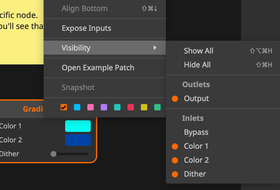

Most nodes have a Bypass inlet, which you can wire up to a bool.
Right click on a node, go to visibility, and check it to make it show up.
You could use the single bool to disable the heavy nodes.

By-passing selected "heavy" nodes using a patch-wide switch might be a workaround but it's not very practical with large patches. I'll use that in the meantime, but I really need to be able to conveniently pause the processing in an entire patch easily, so my feature request remains.

Further, the "heavy node" by-passing switch idea doesn't really achieve what I want anyway, because if I bypass heavy nodes they won't Export.
