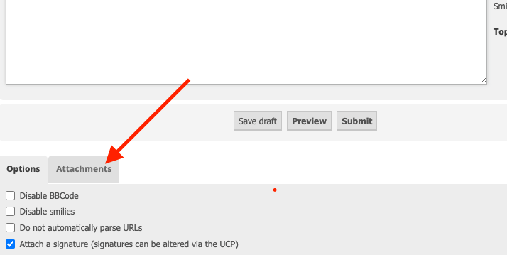

Posts: 7598
Re: Output not Black
You can attach them when posting using the Attachments tab below.

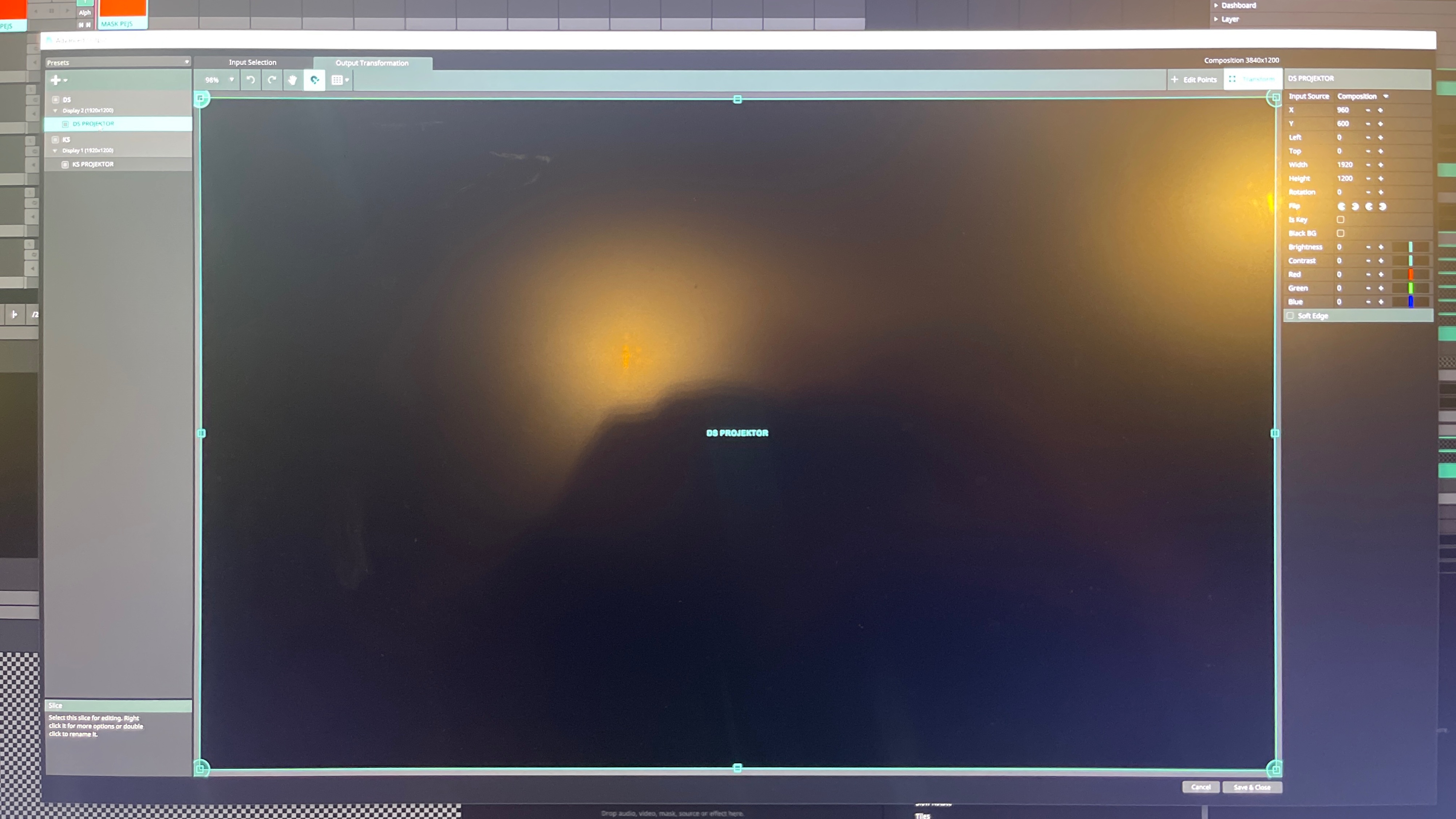

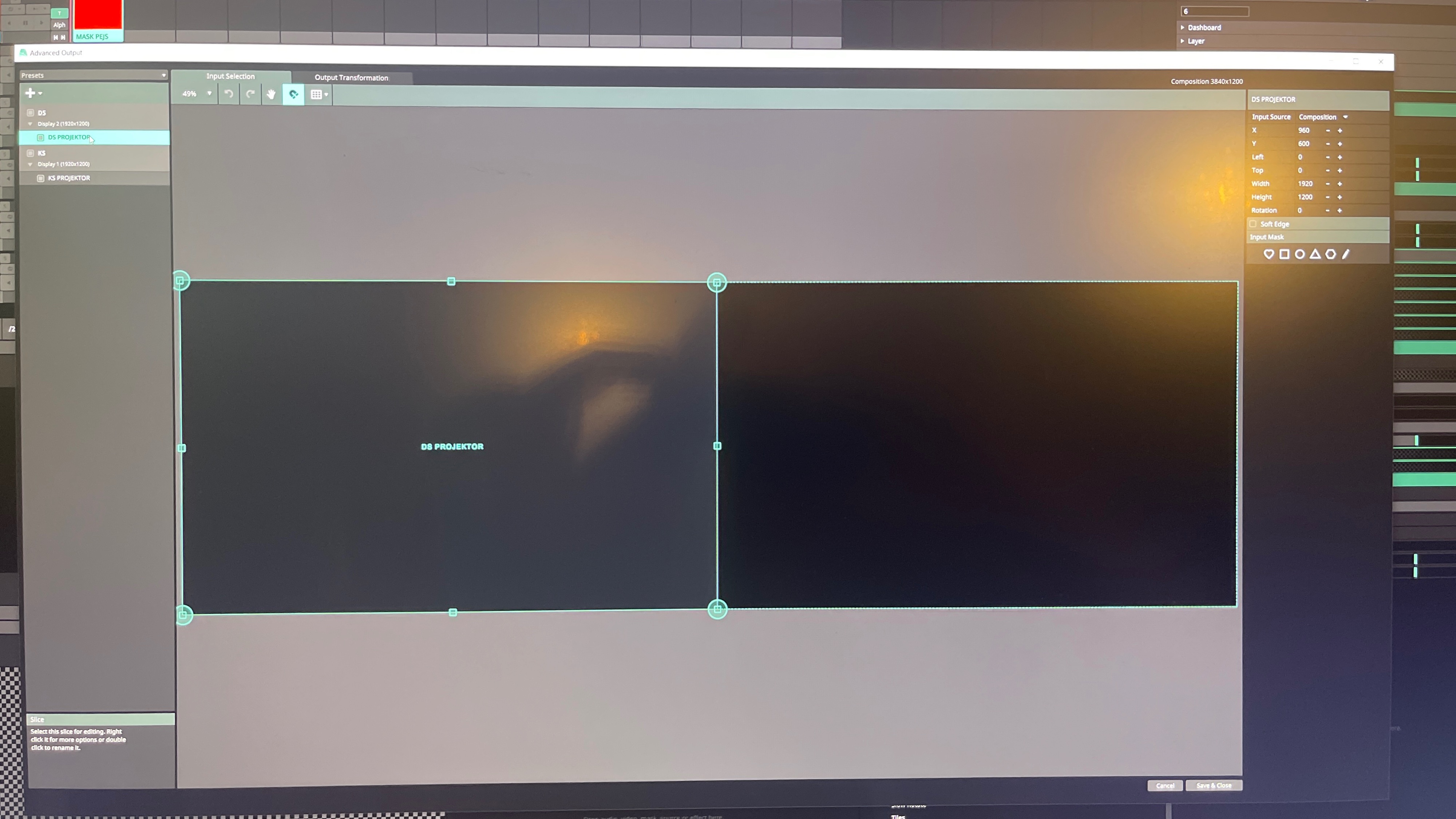

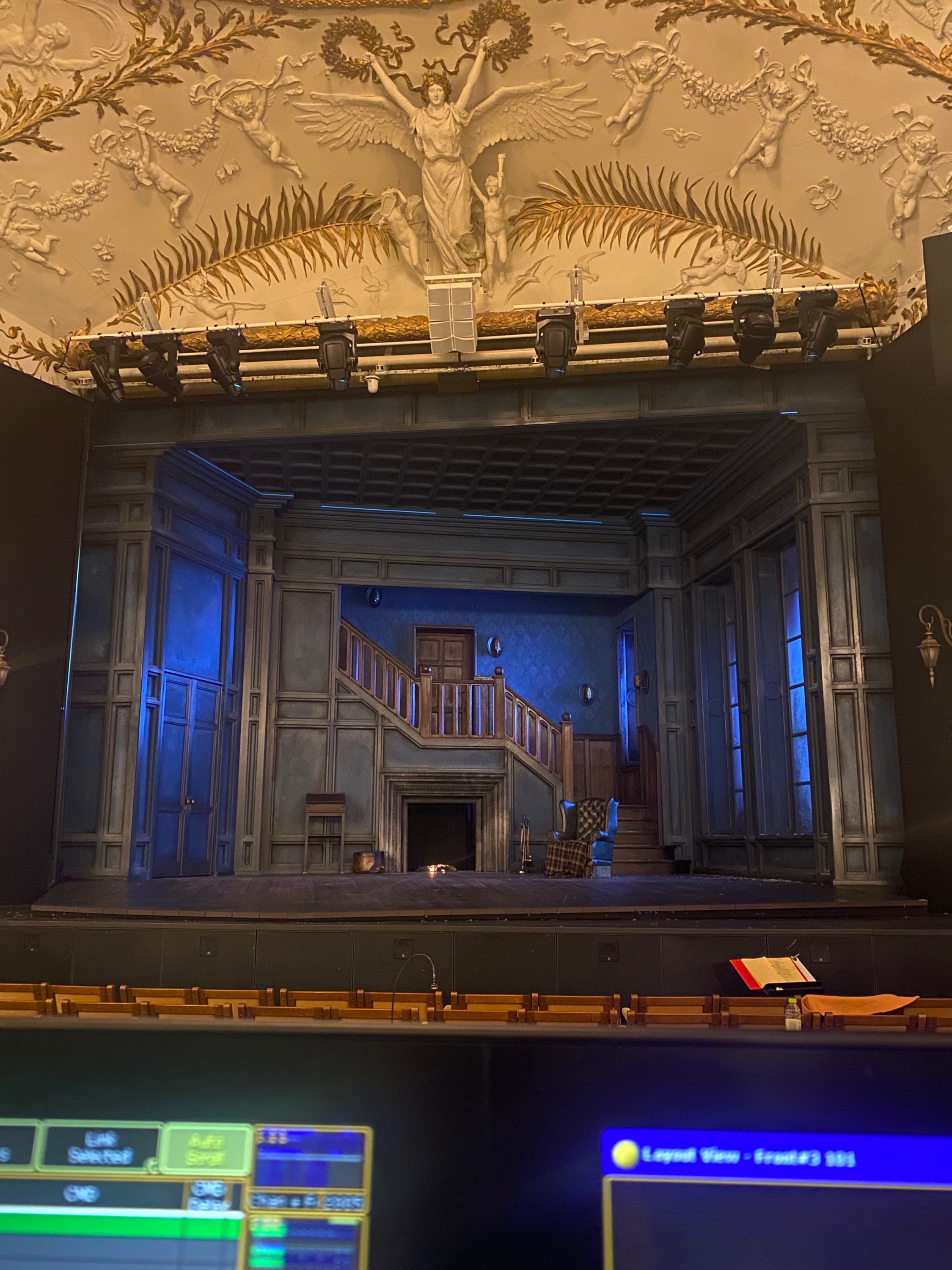

Thanks @zlotan..
Don't know why that did not work for me at first.
I attached picture of my stage, and the advances output.
It is only one projector making the line. it is the one in the top, about one pixel.
Have you any suggestions?
It helped to make the desktop color Black.. however it seems like a bad workaround.
