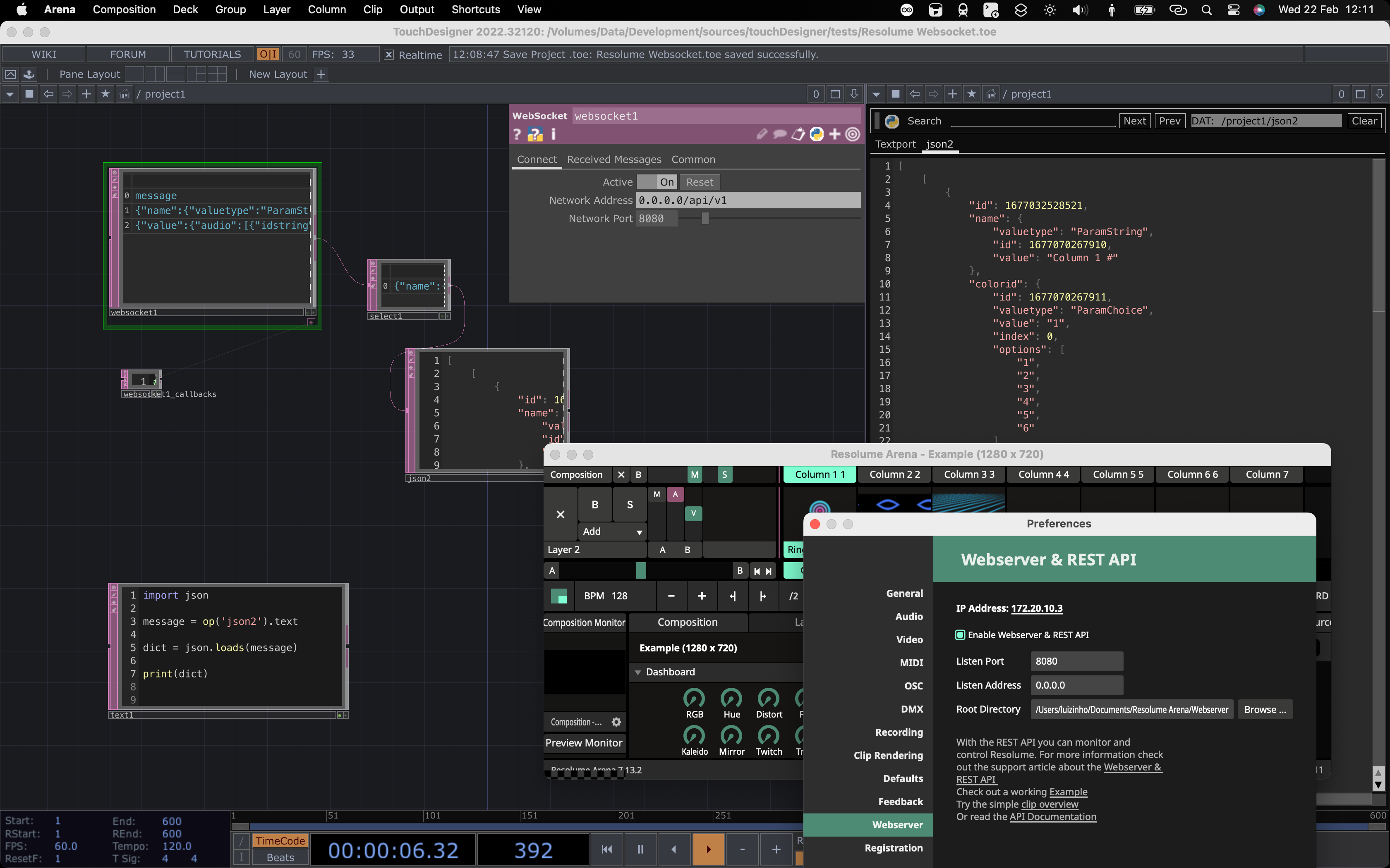

I also use TD, I'm currently studying ways to interact using WebSockets instead of OSC.
Via API, you could scan all the clips in the desired column and preview whatever you want.
Toe File: https://bit.ly/Resolume-Websocket
I didn't use the TD methods, but Python lib, to exemplify faster:
Code: Select all
import json
data = op('json2').text
dict = json.loads(data)
print(dict)
I hope it helps.
