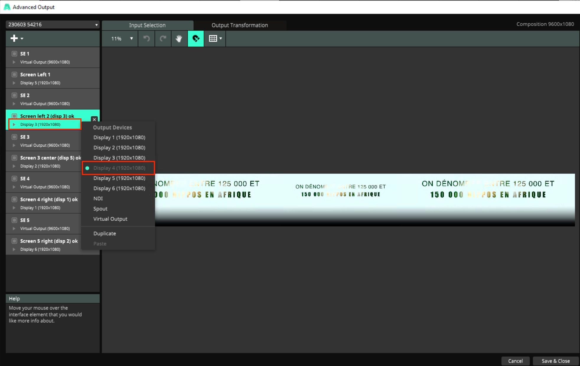

I checked the advanced output setting and found something really odd (see screen capture below):
On the left menu, "Screen left 2 (disp 3) ok" indicates that "Display 3" is assigned, but if I right-click to get the details of the output devices it is indicated that "Display 4" is the one assigned...
Everything comes back to normal once the displays are manually re-assigned to what they were before Resolume swapped them.
