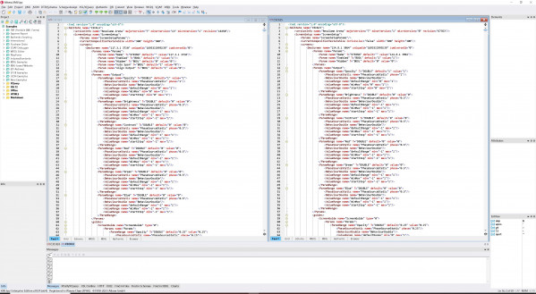

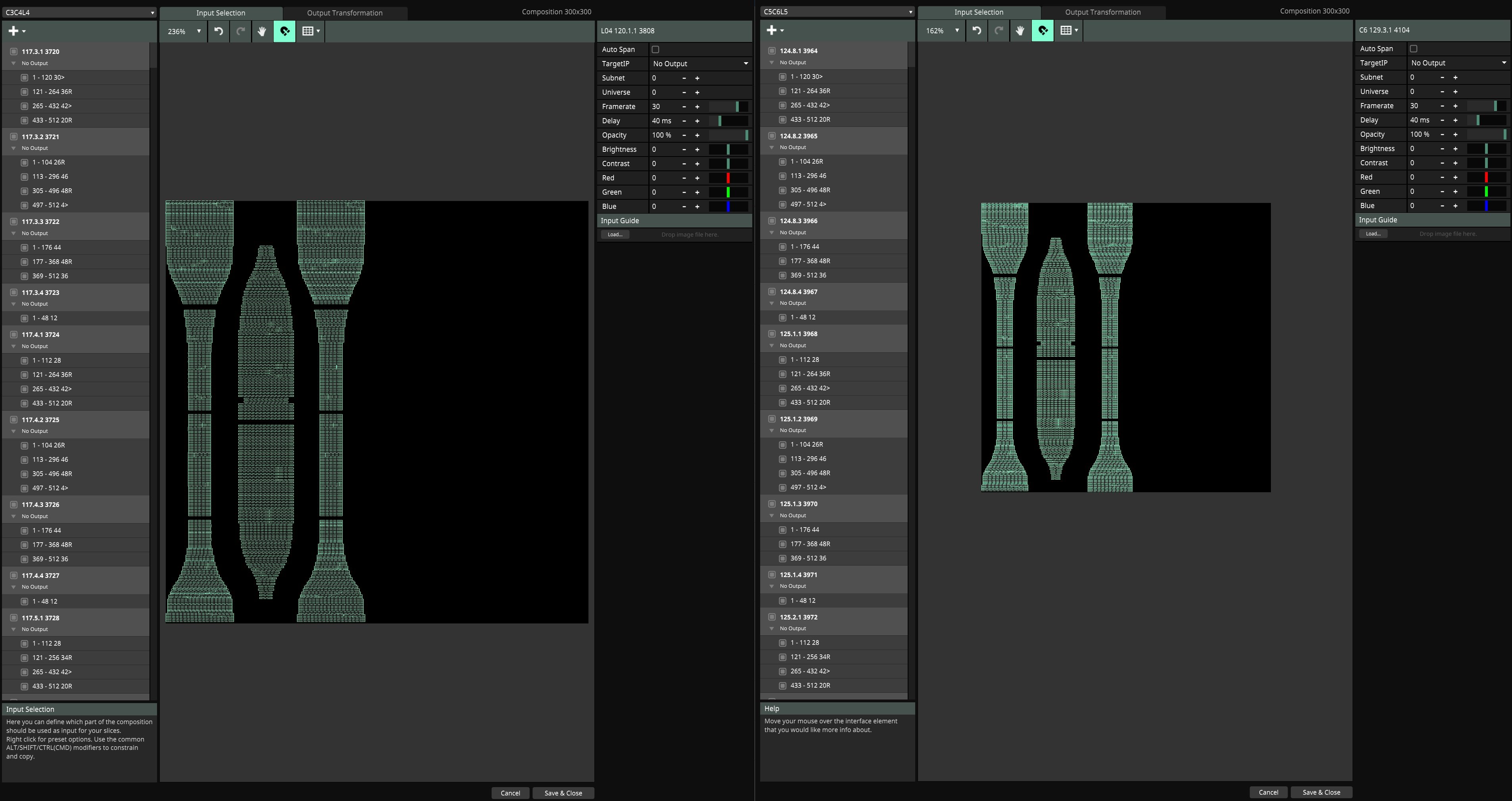

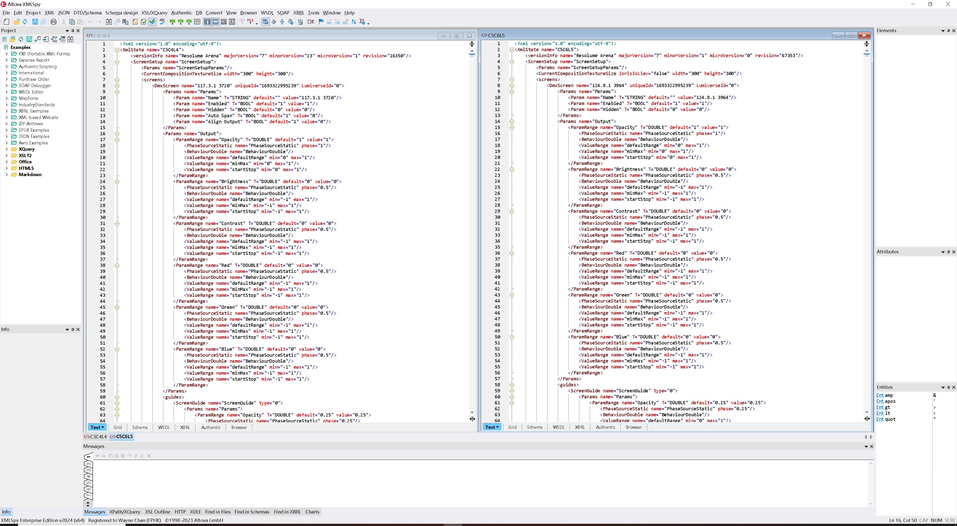

I had a coming project with large scale of façade lighting and we using resolume arena to do this complete mapping and during the project schedule we will split this whole screen to section by section with mapping for the pre-test first , then we will combine all the screen to apply the whole section let say it is a zone testing .
Now i already did the section patch on advance output and files are separated , im now looking for a faster method to merge those separated setting to be one whole screen mapping , so..is it work with xml editor i cab do cut & paste the rows its belong to the fixture contents to another xml file and it generate the new setting ?? i tried copy and paste those luminverse inside ARENA advance ouput from one to another , yep its working properly but its seems that i got lagging on my computer everytime i did the ctl+c ..and then i open another file and do paste it take more times to load those fixtures ...
Or is there any other method i can do this merge ?
thank you soo much for helps !!
PS : Attached with my setting output and some screenshot for your information's

You can also try copying the DMXScreens and pasting them directly to the Advanced output.
