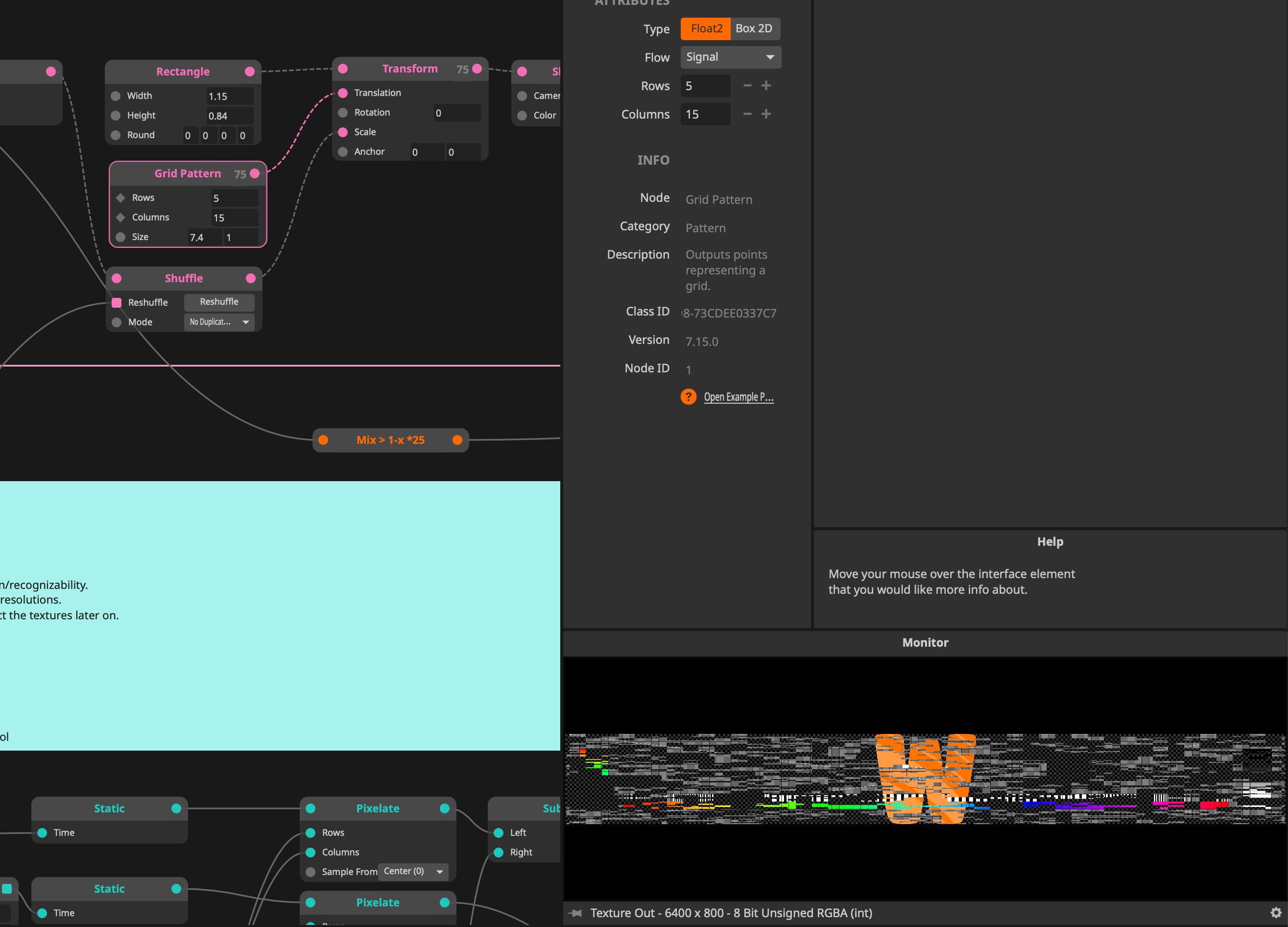

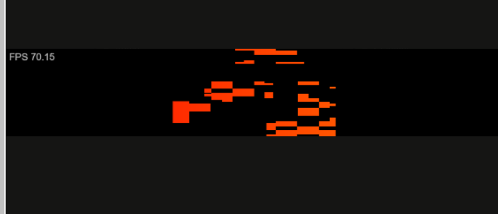

I am using the DigiGlitch example, and when I up the resolution in resolume to 6400x800 px, DigiGlitch stays locked in 1920x1080. I tried to change the patch resolution in wire but it does nothing. Image

The grid pattern for the rectangles is fixed to a specific patch size - actually patch aspect ratio.
