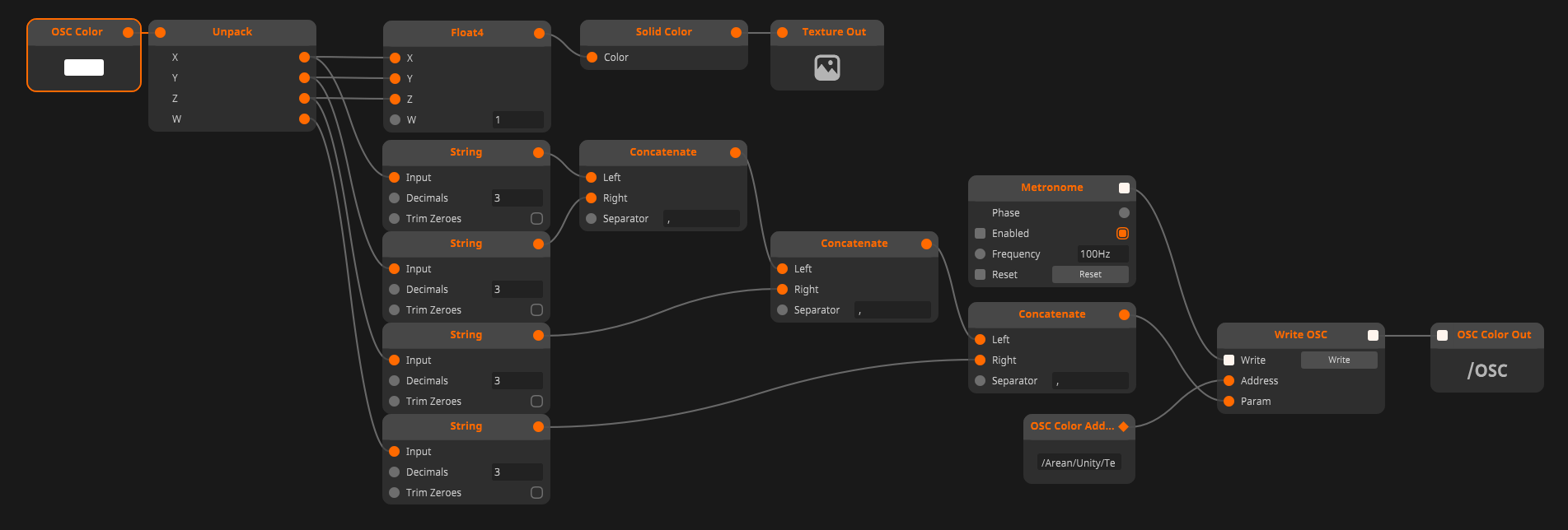

*image of my Wire Patch

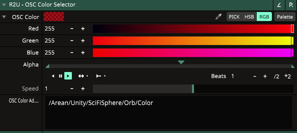

*image the source properties in Arena
Screenshot 2024-02-23 205622.png (23.77 KiB) Viewed 1745 times

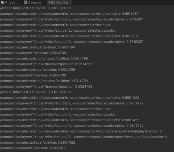

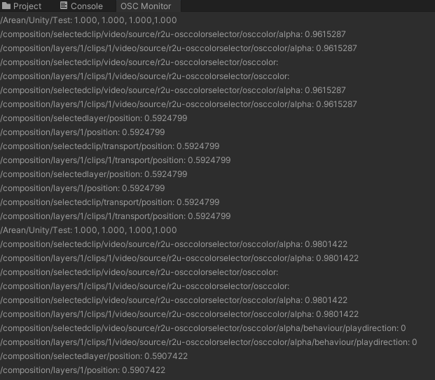

*image of my OSC monitor in Unity using Arena

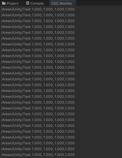

*image of my OSC monitor in Unity using just Wire

is this a typo?
Képernyőfotó 2024-02-26 - 10.52.07.png (1.06 KiB) Viewed 1717 times

yes lol. however thats not the issue.
1. it works and i just havent fixed the typo
2. The typo is consistent across all of my projects

The messages from the patch seem to be there in your Unity - Arena screenshot, so what's the issue?

Thoses are from wire itself. I had forgot to disable it when I took a screen shot
